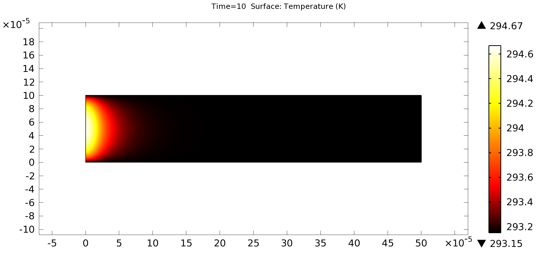

I solve heat transfer, flow and PDE projects together. My problem is time-dependent. Comsol successfully solves it but there is a problem with the solution. When I plot 2D temperature distribution and start changing the time, the value of the temperature is not changed. I have read in the forum that maybe this problem comes from initial values but I can't come up with a solution for it.

p.s. I get a distribution of the temperature but it doesn't change with time. Temperature distribution is like a Gaussian distribution. find attached.
From the experiment I know that temperature should gradually rise then it becomes constant after several seconds.

I have read in the forum that Comsol changes initial values to find a convergent solution for the problem. I think that's the problem why I get other values after solving the problem. But in my problem values of variables are small. That's why I am concerned with the initial value of the velocity after solving the problem. Expected value of the velocity is about 15 um/sec but I get 10^-9 instead. My domain height = 100um=0.0001m and width = 200um, but the with is not playing any role here.
In Heat transfer as an initial value T0=293.5K has been used.
In Laminar flow Velocity(t=0)=0 (both r and z components).
In laminar flow physics I don't have any boundary conditions. There is no such option in this physics as far as I know. In Heat transfer physics I just fixed temperature on the walls.
About time scale. From the experiment it was ascertained that I can solve this problem within 10sec. After 10sec. material becomes isotropic and my calculations become meaningless.
About constant temperature on the walls. I tried to remove it and now I see the evolution of the temperature but It becomes extremely high within the first second. As always, temperature is extremely high - more than 600K.
