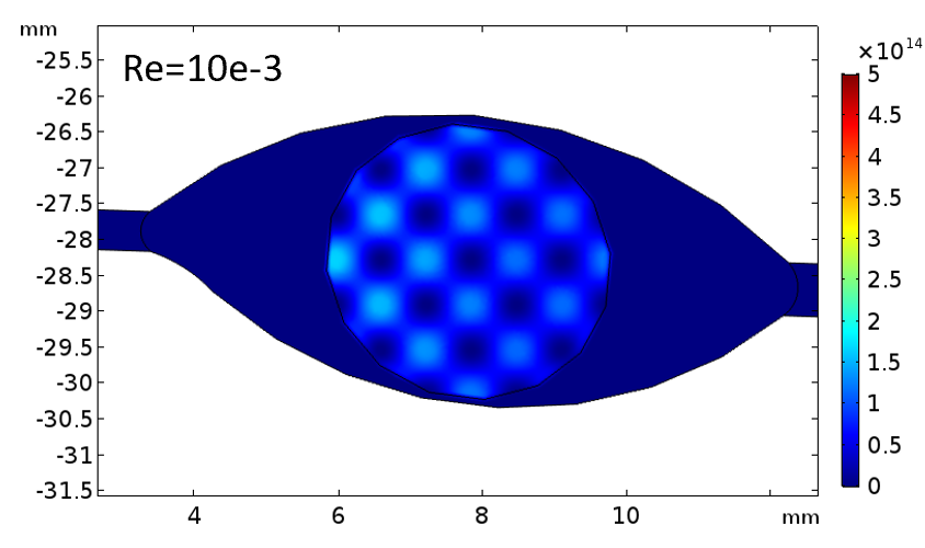

Thanks alot for your reply Jeff, and sorry for the long delay. For anyone looking this up later, i did find my issue. Because my model was i only a few mm scale, my sine-cosine wave was too large to give an impact on my initial concentrations. Increasing the frequency of the sine-cosine plane with around 10^3 fixed my problem. My initial condition thus ended up being Cx0+Cx0sin(1000x)cos(1000y), resulting in a good nonhomogenous initial condition. I have included an image for anyone looking this up in the future.
Hi Jeff Thanks alot for your reply Jeff, and sorry for the long delay. For anyone looking this up later, i did find my issue. Because my model was i only a few mm scale, my sine-cosine wave was too large to give an impact on my initial concentrations. Increasing the frequency of the sine-cosine plane with around 10^3 fixed my problem. My initial condition thus ended up being Cx0+Cx0*sin(1000x)*cos(1000y), resulting in a good nonhomogenous initial condition. I have included an image for anyone looking this up in the future.
