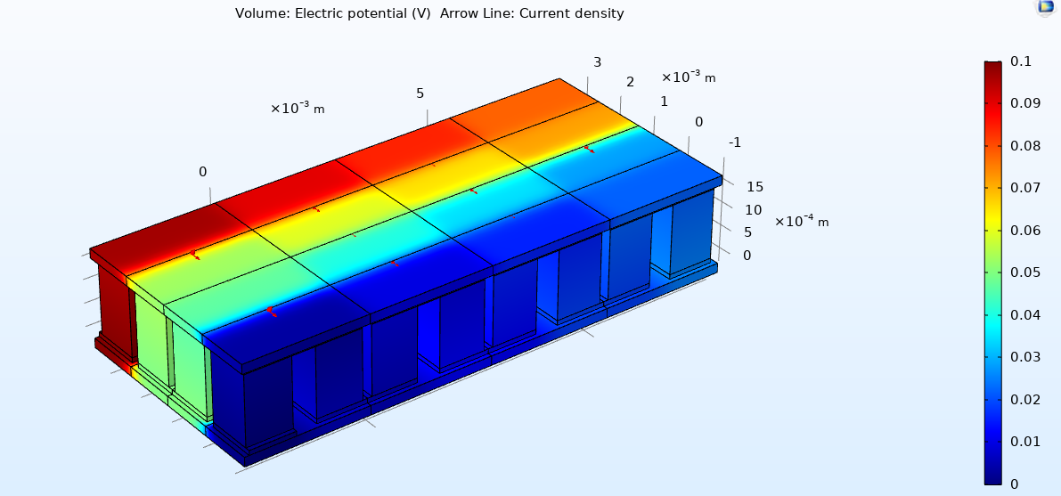

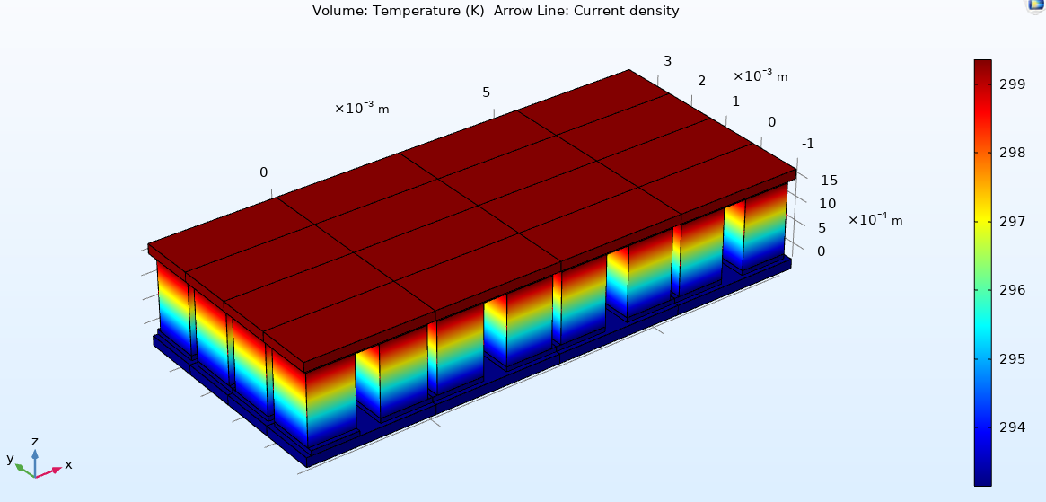

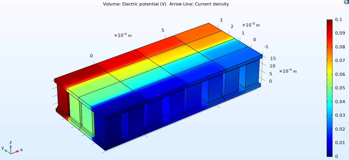

I have a model of a thermoelectric generator made of Bi2Te3 and isolated with alumina.
However, the isolator layer doesnt have constant voltage, despite the very low electrical conductivity value being 10 to the power of -20. The temperature profile seems fine.
I have attached the simulation for temperature and voltage.
Where have I made a mistake? How can I fix this?

Maria,
you observe a potential distribution BECAUSE you are looking at an insulator. If you want to see spatially constant potential you must give the thing higher conductivity. I would say it is correct as it is.
Cheers Edgar

Good morning Edgar,
I can't seem to understand why that is. I have increased the conductivy 10^40 times and the distribution remains uneven.
Could you indicate me to any literature where can I read on this phenomenon?
Thank you in advance
Best regards, Maria
Good morning Edgar, I can't seem to understand why that is. I have increased the conductivy 10^40 times and the distribution remains uneven. Could you indicate me to any literature where can I read on this phenomenon? Thank you in advance Best regards, Maria
Posted: 7 years ago 2 gen 2019, 05:16 GMT-5
Maria,
yes that is strange. Something else must be wrong in the model. You might consider to upload the model here or turn to the Comsol support. Unfortunately I won't be able to do much because we don't have the semiconductor module.
Cheers and HNY, Edgar
