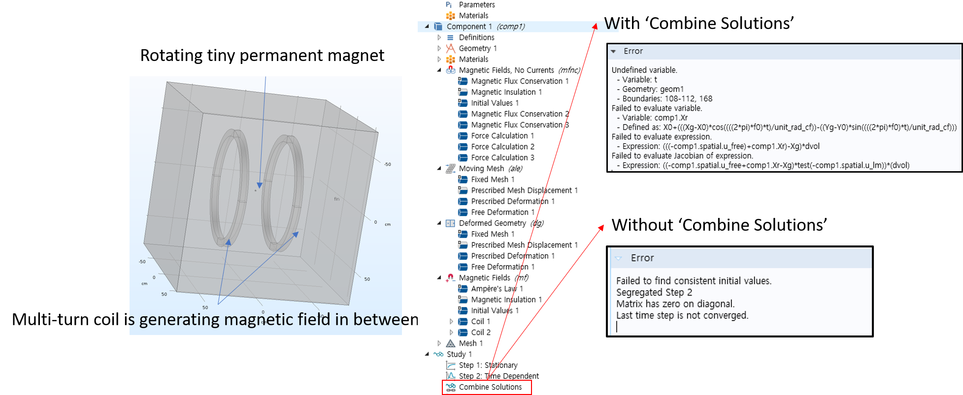

I've simulated rotating permanent magnet(Time Dependent) inside a coil with flowing current of 1A(stationary) and trying to retrieve the data of magnetic torque and force that is applied to permanent magnet in time variant.
I added 2 different physics, 'Magnetic Fields, No current(mfnc)' and 'Magnetic Fields(mf)' for permanent magnet and multi-turn coil respectively.
A 'moving mesh' and 'Deformed Geometry' study is also added to make permanent magnet's rotation.
A single mesh is built for all geometry including permanent manget and coil.
HERE IS THE ISSUE. I arranged 'stationary study' and 'time dependent study' in a row and applied the 'combine solution' but ended up with initial value error.
I need a comment in a big perspective, how to make this simualtion framework. If this simulation that I am trying to do understandable, could you please give me a help?
(Attached picture is schema of my simulation)

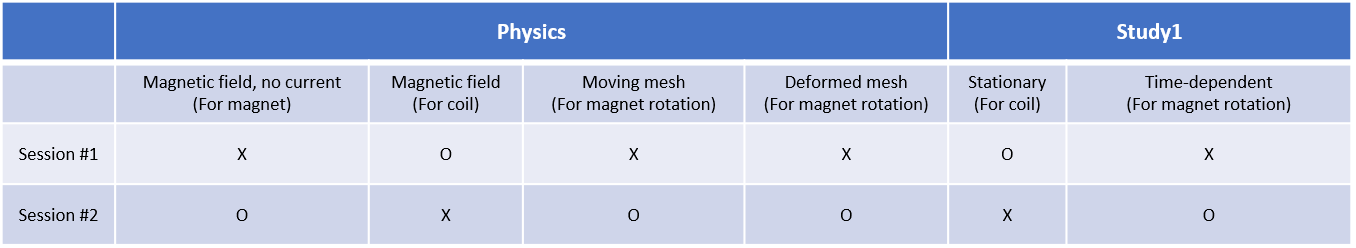

Posted: 7 years ago 20 dic 2018, 20:27 GMT-5
Thank you for your answer.
From my understanding of your comment, I outta temporailty disable deformed and moving mesh physics to proceed stationary study in advance. And I can enable deformed mesh and moving mesh for another time-dependent study. Am I correct? (Please check up the picture I attched below.)
In that case, could the data from multi-turn coil and permanent magnet be remained and interact? I thought I have to make all the study to be done at once.
Secondly, where can I write analytical expression directly? I mean, the analytical expression that I wrote so far is for the rotation of permanent magnet(time-dependent) and that's all. You mean there needed an expression in stationary study? Actually I have no idea why you give me an example of temperature.
Thank you.
Thank you for your answer. From my understanding of your comment, I outta temporailty disable deformed and moving mesh physics to proceed stationary study in advance. And I can enable deformed mesh and moving mesh for another time-dependent study. Am I correct? (Please check up the picture I attched below.) In that case, could the data from multi-turn coil and permanent magnet be remained and interact? I thought I have to make all the study to be done at once. Secondly, where can I write analytical expression directly? I mean, the analytical expression that I wrote so far is for the rotation of permanent magnet(time-dependent) and that's all. You mean there needed an expression in stationary study? Actually I have no idea why you give me an example of temperature. Thank you.
Posted: 7 years ago 21 dic 2018, 04:49 GMT-5
Dear. Sohan Birla
Thanks to your comment, I could proceed the simulation without any error. What I did referring to your comment is making 2 study set(stationaey, time-dependent) and independently simulated permanent magnet(mfnc) and multi-turn coil(mf).
However, the problem was that each study result shows each result, not being interacted. So, I activated only time-dependent study for both permanent magnet and multi-turn coil, however, I ended up facing error like below.
  • "Failed to find consistent initial values. Internal error in solve stage of Auxiliary-space Maxwell Solver. HYPRE error description: Generic error. Last time step is not converged."*
Can I ask further idea of you?
Best, Jason
