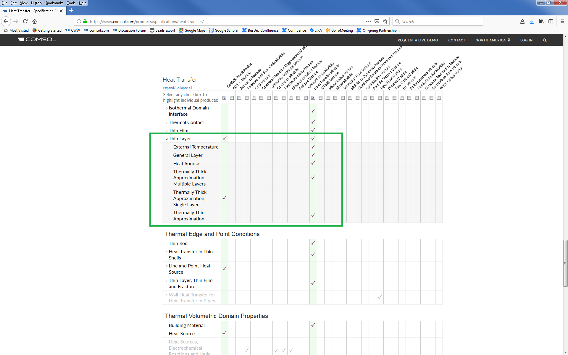

Hi Jeff,
Ah, I can see that my licence doesn't include the Heat Tranfer Module.
In the 'Heat Transfer in Solid (ht)' physics node that I have there is still a 'Thin Layer' option, how is this different to what is offered in the module?
(I'm guessing that it can only do a 'thermally thick approximation' of a thermal boundary resistance...?)
Alex
Hi Jeff, Ah, I can see that my licence doesn't include the Heat Tranfer Module. In the 'Heat Transfer in Solid (ht)' physics node that I have there is still a 'Thin Layer' option, how is this different to what is offered in the module? (I'm guessing that it can only do a 'thermally thick approximation' of a thermal boundary resistance...?) Best regards, Alex
Posted: 7 years ago 19 dic 2018, 14:36 CET
The attached screenshot (from the "Specification Chart" on our website) compares what's in the core package vs the Heat Transfer Module as far as Thin Layers on boundaries.
Contact your COMSOL rep for a trial of the Heat Transfer Module: www.comsol.com/contact.
Jeff Hiller
The attached screenshot (from the "Specification Chart" on our website) compares what's in the core package vs the Heat Transfer Module as far as Thin Layers on boundaries. Contact your COMSOL rep for a trial of the Heat Transfer Module: www.comsol.com/contact. Jeff
