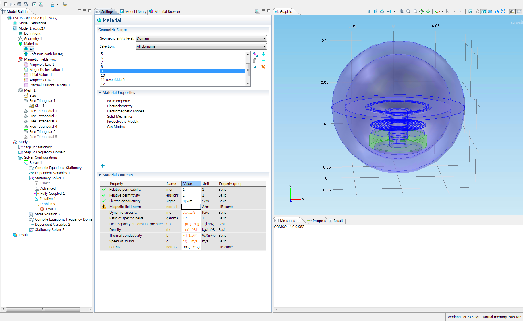

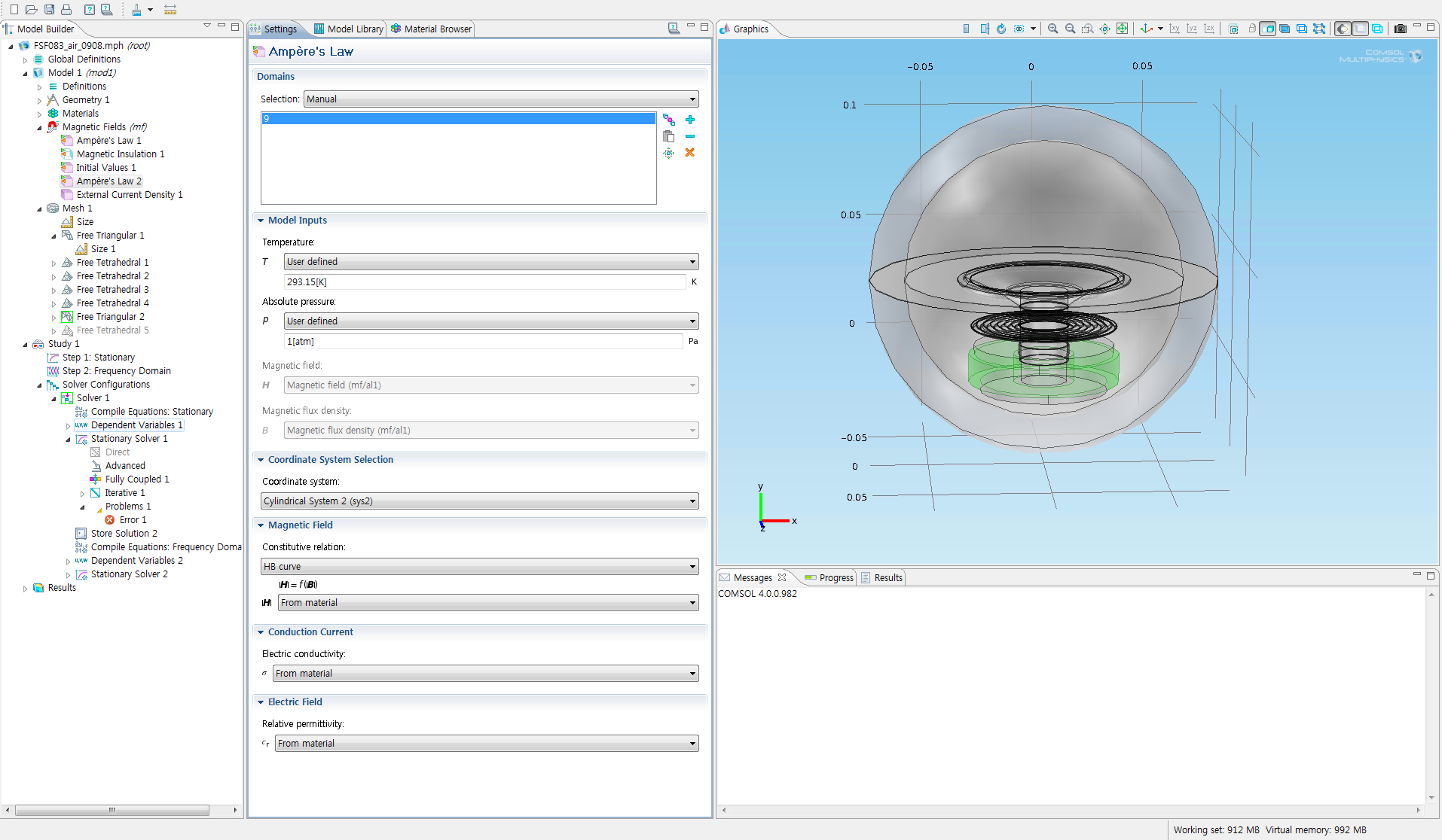

Posted: 1 decade ago 14 set 2011, 15:01 CEST
Hi!
Sorry,, My problem is like this. (Attach file)
I change the setting for second "Ampere's Law" from "Magnetic Field" in "Remanent flux density" to "HB curve".
Then material property in air need to "Magnetic Field norm"
Second "Ampere's Law" domains 9, but domains 9 is Air domain.
(I follow the COMSOL example 2D - Symmetric "Loudspeaker Driver")
Please let me know how to solve it.
Hi! Sorry,, My problem is like this. (Attach file) I change the setting for second "Ampere's Law" from "Magnetic Field" in "Remanent flux density" to "HB curve". Then material property in air need to "Magnetic Field norm" Second "Ampere's Law" domains 9, but domains 9 is Air domain. (I follow the COMSOL example 2D - Symmetric "Loudspeaker Driver") Please let me know how to solve it.
Posted: 1 decade ago 15 set 2011, 11:12 CEST
Hi!
In the example this domain is defined with "remanent flux density" with 0.4T; try this one, if you want to have a permanent magnet. In your case I think, it should be a value for B in y-direction.
Ralf
Hi! In the example this domain is defined with "remanent flux density" with 0.4T; try this one, if you want to have a permanent magnet. In your case I think, it should be a value for B in y-direction. Ralf
