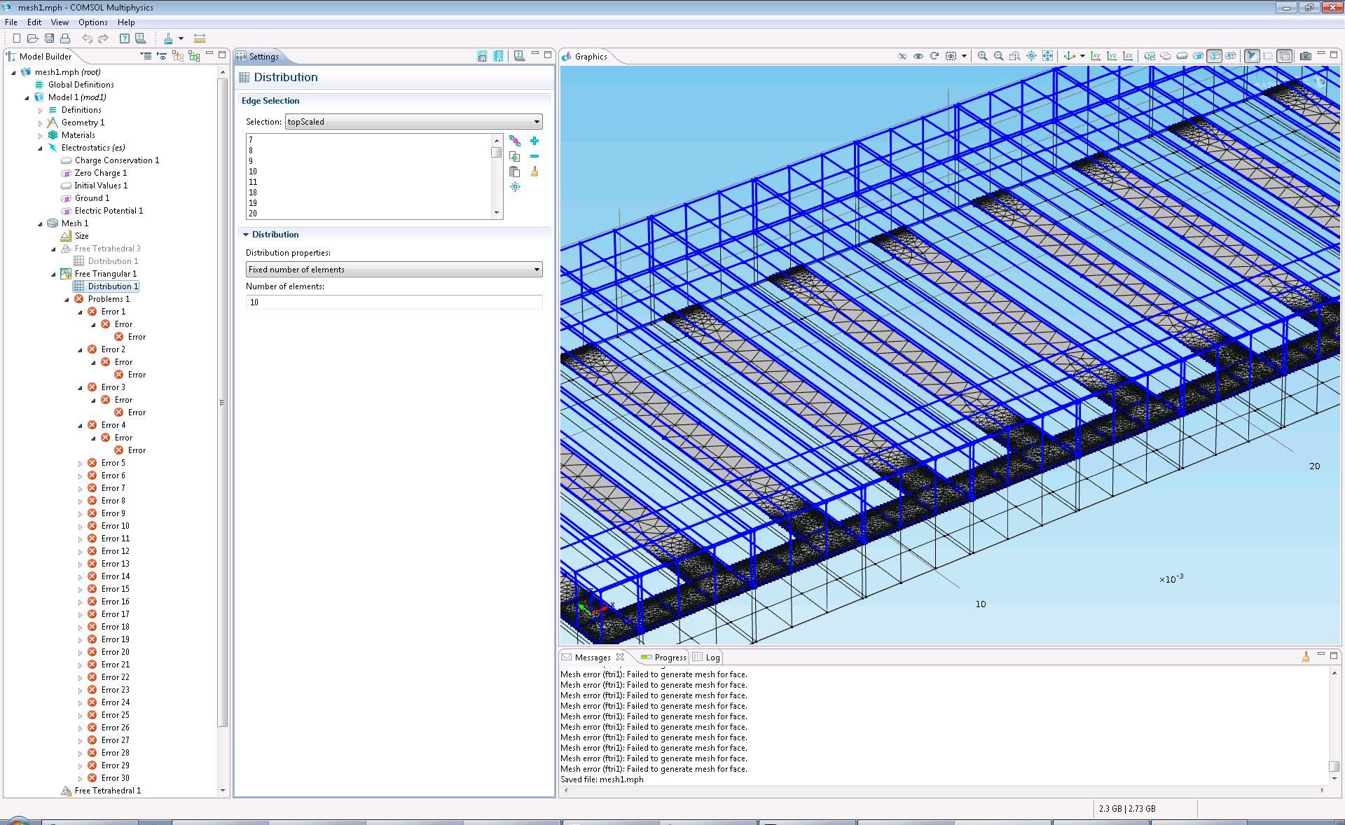

im trying to mesh part of the thin layer using free triangular and a distribution set to 10 ( i labeled it side1, one of the copper electrodes) but it is taking quite a long time, even with my i7 sandy bridge cpu. Im not sure if im doing what you described. Do you mind meshing a section of it for me as an example? my email is chowryan@gmail.com
Thanks,
Ryan Chow
im trying to mesh part of the thin layer using free triangular and a distribution set to 10 ( i labeled it side1, one of the copper electrodes) but it is taking quite a long time, even with my i7 sandy bridge cpu. Im not sure if im doing what you described. Do you mind meshing a section of it for me as an example? my email is chowryan@gmail.com Thanks, Ryan Chow

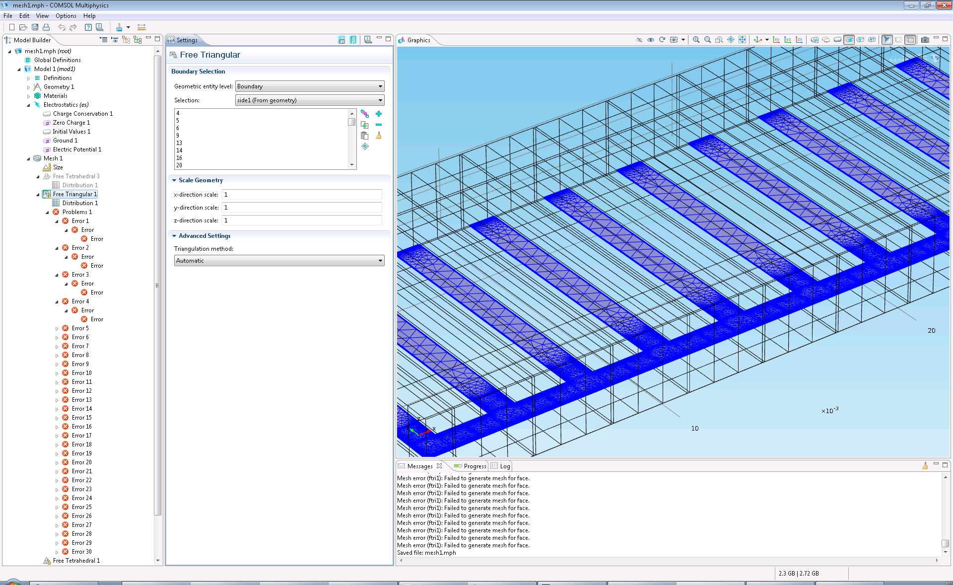

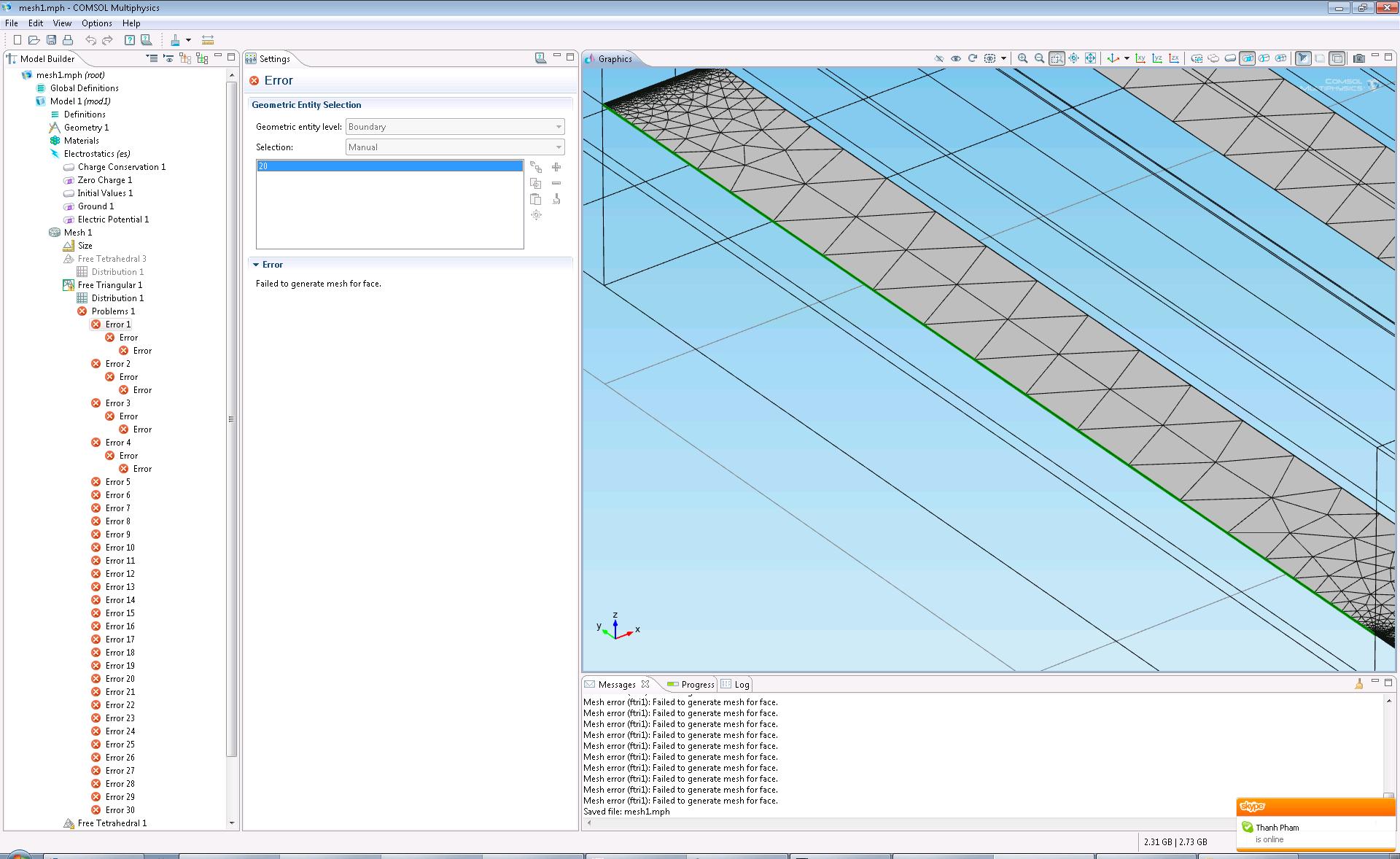

ok i tried following your advice but am not sure if it is correct. the mesh completes to 100% (after about an hour or so) but at the last moment gives errors on several of the thin faces. Ive attached some jpegs showing the mesh settings and errors.
Thanks!
ok i tried following your advice but am not sure if it is correct. the mesh completes to 100% (after about an hour or so) but at the last moment gives errors on several of the thin faces. Ive attached some jpegs showing the mesh settings and errors. Thanks!
