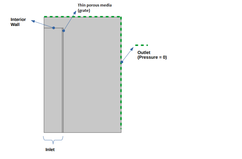

I would like you to clarify to me about the simulation of flow through metal grates. I read some scientific articles on this type of simulation, in which they considered the grid to be a thin porous medium. I know there is the porous media module in Comsol. However, a question arises: My model has a turbulent flow (I intend to apply the k-e turbulence model), but I do not know which flow model is used internally by the porous media module (whether it is laminar or turbulent).
I also tried to conjugate the porous media module with the k-e turbulence module. However, in doing so, I noticed that the constructed model did not change its behavior with the alteration of thin porous medium parameters (porosity and permeability), it seems that the conjunction of the two models was not successful.
It is important to note that I do not have the equivalent values of porosity and permeability of the metal grate, I was only doing tests to verify the possibility of using the porous media module.

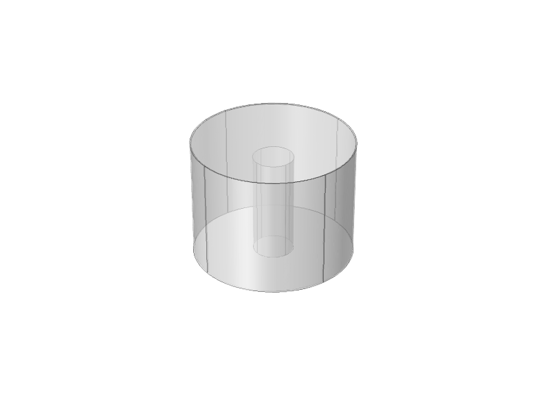

Attached is the illustration of the geometry of the model (axissimetric geometry of a dryer) and the 3D geometry.
