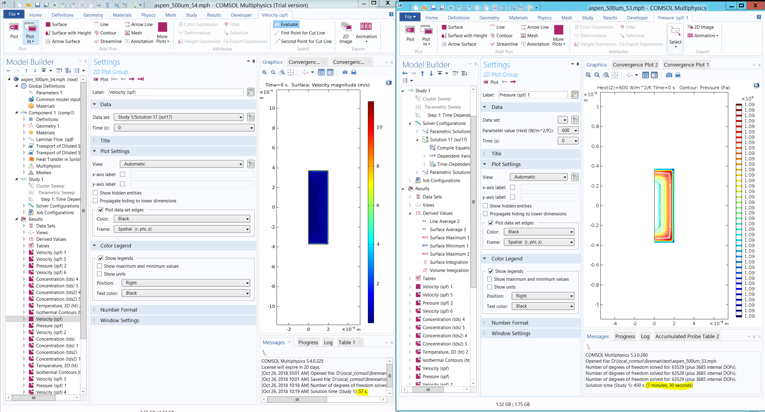

I think that we should be happy about the performance improvement. It was not an easy thing for us to fix.
The reason for the dramatic improvement is that we are no longer using Windows' built in memory allocator for computers with more than 8 cores. Instead, we are using a scalable memory allocator adapted for modern computers with many cores and several CPU sockets. The new memory allocator uses slightly more memory than the one included in Windows' but yields better performance, as you pointed out.

                                                    Hi Ed,
I completely agree. (I was being sarcastic.) Time is money!

I'm sure Ed has more to say on this, but be sure to go to preferences/ Multicore and Cluster Computing / Memory allocator set to "Optimized for Multicore".
