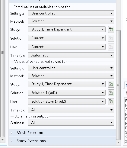

Posted: 7 years ago 8 nov 2018, 11:22 GMT-5
Dear Jeff, Many thanks. So I attached my initial values set up for second sub-study (T). what you are saying is that even with this arrangement, I can still uncheck the v,p in the store solutions?
Regards, Asal
Dear Jeff, Many thanks. So I attached my initial values set up for second sub-study (T). what you are saying is that even with this arrangement, I can still uncheck the v,p in the store solutions? Regards, Asal
