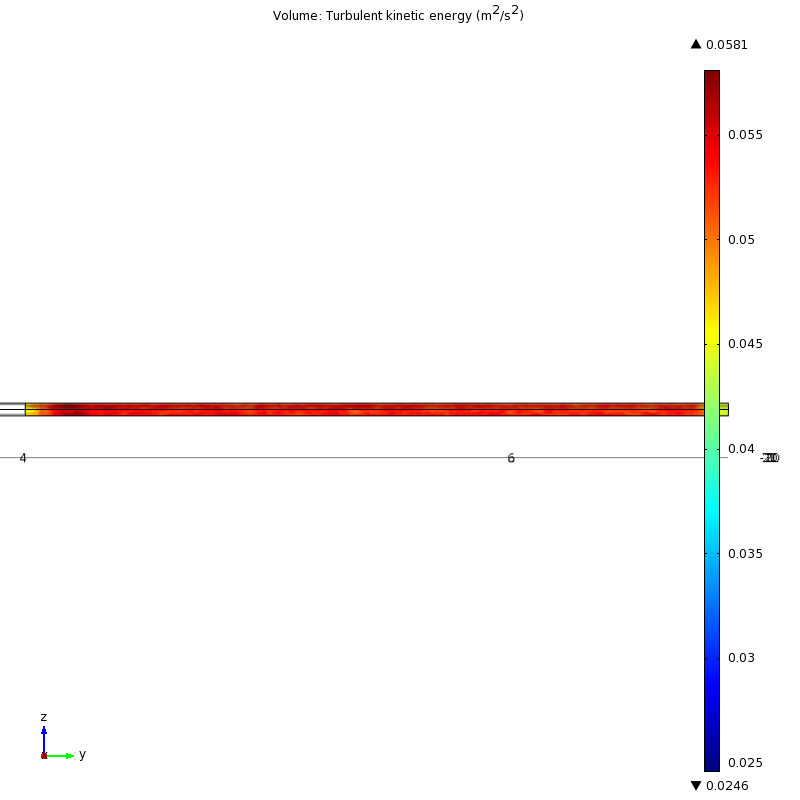

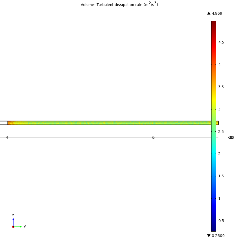

I am trying to model a 3D Pipe multiphase flow using the Mixture Model for turbulent flow.
And although the model converges I keep getting the numerical variations at pipe continuities
and the profile of K and EPSILON are show some numerical instability...
I have a 4 m cylinder to simulate a 4 m section pipe to allow the flow to fully develop, than I have a 2.9 m section
that is the one I am interested...
However both sections present a "spotted" profile in the wall for the K and Epsilon values...
The File is too big to upload...so it uploaded some PNG Files so you can see the results...
Hope someone can help. Cheers!
Rui

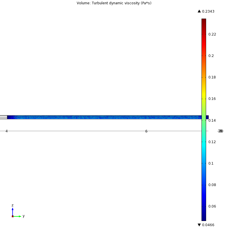

I would rather have a look at the dimensionless wall distance and at the dimensional wall distance. It may be of interest also to plot the ratio of the turbulent viscosity on the dynamic viscosity, usually the ratio is over 100:1.
It is hard to gauge the variations in K and epsilon from the images but it seems they are fairly small oscillations.

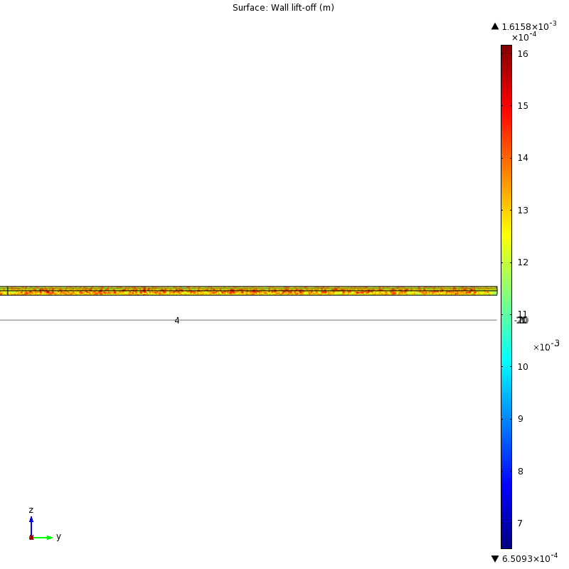

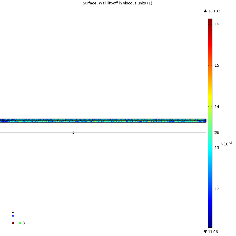

In any surface plot you select 'Turbulent flow' and then in the list there are 'Wall lift-off (mod1.spf.delta_w)' and 'Wall lift-off in viscous units (mod1.spf.d_w_plus)'.
Cheers
here are the screenshots. And thanks for the tips.
I'll be looking forward for your assessment.
Cheers!
I think that first of all you may want to study about what boundary layers are, the best introductory book I have found so far on boundary layer theory is 'Foundations of boundary layer theory for momentum, heat and mass transfer', J. Schetz, ISBN 0133293343.
For this time a very brief summary may be in order. Turbulent flow is characterized by very large variations in the velocity field; comsol uses a mathematical technique to approximate such variations, known as Reynolds average, so that it computes for the mean velocity components. A major characteristic is that it does not solve for the fluid motion at the wall and very close to it, such region is known as a boundary layer wherein velocity grows from zero (at the wall) to some value close to the average velocity of the bulk of the fluid. In this case the boundary layer is said to be turbulent and can be divided into three sub-layers, laminar, intermediate and turbulent ones (or similar names). Because comsol does not solve for any of these three sub-layers, it is crucial to make sure that its approximation is sound enough, to wit, that the dimensionless distance from the wall is 11.06 or very close to it, and at the same time that the dimensional distance from the wall is very small compared to some characteristic length.
I know this is an extremely short version of it all but I would strongly suggest to study the theory first of all. Even in the comsol manual there is something to chew on.
In this case the dimensionless distance hovers a bit above 11.06 which is not bad but it oscillates maybe a bit too much. The dimensional distance ranges from less than 1mm to more than 1mm, it sounds suspiscious. However, the images are not easy to read. It is also important to relate the dimensional distance to the characteristic legth of the problem, which I would say is the diameter of the pipe.
How to correct for problems with the d_wall and w_wall_plus? By intervening on the mesh close to the boundary of the geometry, that is by making the first boundary layer much closer to the wall (maybe the distance from the boundary for the first one should be less than 1mm) and use quite a number of boundary layers (5, 6, 8, 12?).
