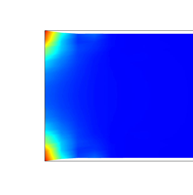

1: If you look at the attached picture, you can see that the model is somehow fixed at the rotary axis. I already included the "rigid body movement suppession node". But...

Hi Sven,
It is difficult to guess, but maybe you have added Rigid Motion Suppression to more than one of the physics interfaces.

1: You was right. I had the "rigid motion suppr." node on every interface. This problem was solved very fast. Thanks for that.

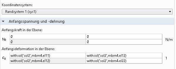

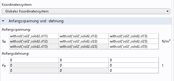

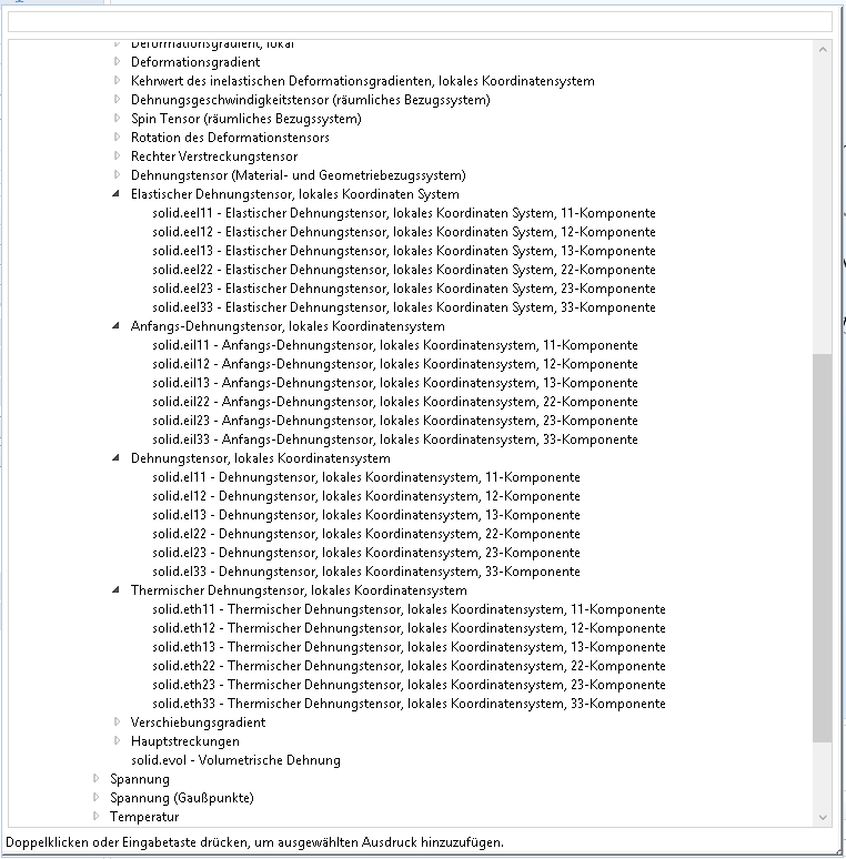

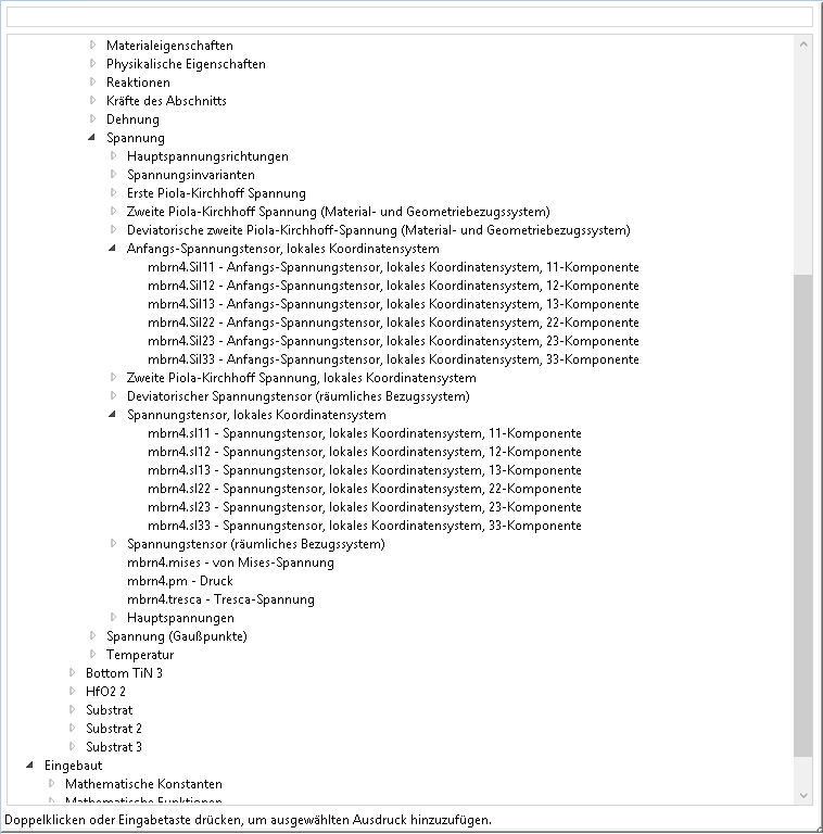

2: I choose the way with the several studies for each depositing step, so that each studie run´s through all previous interfaces too. So I build up the model for each solution- and "depositing"- step + the new layer. To the "already existing" layers and the substrat I added an "initial stressund strain" node. Every existing layer and substrat I pointet to the same layer at the previous solution regarding the stress or strain. But at this point I´m still struggeling a bit with the right operator synthax. The "initial stressund strain" node for solid and membrane is different. Especially for the membrane it´s a bit confusing. I´ve attached 2 pictures for solid and membranes. Additionally I attached 2 pictures of possible strain and stress tensor components. There are several possible tensors, but which one is appropriating? Sure I could try them all and take the one which gives me the best results, but i would like to understand there meaning. Altogether, the model runs, even if the results are not matching the measurements. But i guess it´s also a matter of a lot of material property assumptions.

Hi Sven,
I think you are on the right track. With regard to the strains to use, I believe you should use the elastic strains (mbrn.eel11 etc.). It is the elastic strain that is producing stress, so by "offsetting" using the elastic strain, you ensure a stress-free activation of a layer.
Good luck!
Mats
Hi Mats,
thanks for the hint. It seems that this has the right effect on my model. The results are much more plausible and fitting to the real measurements now.
