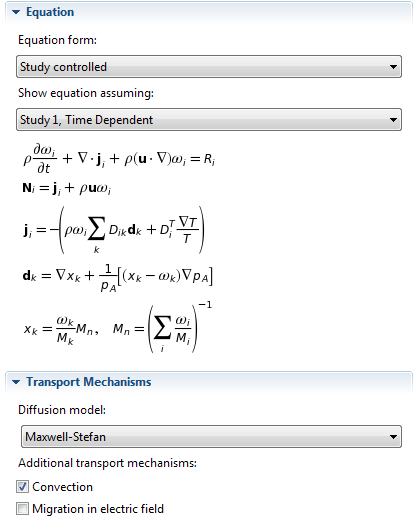

Anyone has any idea how can i get the conservative form of the convective flux in the case of transport of concentrated species module in comsol 4.1/4.2. please have a look at the attached file. In the third term on the left side of the first equation, I want velocity and rho terms inside the del operator, but I don't have such option in comsol 4.1. But in comsol 3.5a we have an option to select conservative or nonconservative form.
thanks
