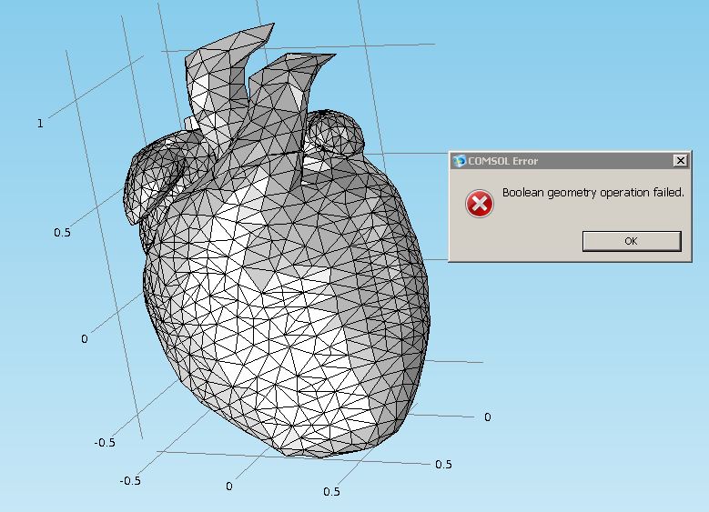

Hi !
I am almost getting crazy by trying to form a UNION of my complex geometry in COMSOL 4.2.
My geometry consists of parts of the human heart that were obtained from MRT scans (atria, ventricles as well as right and left blood cavities filling the interior of the heart) and represented as 3D volume geometry in ACIS ".sat" format. If I import into COMSOL only the atria and ventricles without blood cavities I can form a UNION of my geometry. In similarity, if I import only the left and right blood cavities, I also can form a UNION of them. However, when I put them all together, I am always getting the message: "Boolean geometry operation failed". As I already tried the "CAD import module kernel" and I played a lot with the import and repair tolerances I do not know what to do anymore. I just attach to this message the files representing my heart model in .SAT - format and a screenshot of the error message that I get (in the file "error_message.jpg"), hopping that somebody will help me. I am setting the units of COMSOL to centimeters and import the geometry using the length unit from COMSOL. However, it looks like COMSOL does not understand it right (screenshot in "error_message.jpg").
Thank you for any help,
victor
P.S. Henna, have you solved your problem ?
Hi ! I am almost getting crazy by trying to form a UNION of my complex geometry in COMSOL 4.2. My geometry consists of parts of the human heart that were obtained from MRT scans (atria, ventricles as well as right and left blood cavities filling the interior of the heart) and represented as 3D volume geometry in ACIS ".sat" format. If I import into COMSOL only the atria and ventricles without blood cavities I can form a UNION of my geometry. In similarity, if I import only the left and right blood cavities, I also can form a UNION of them. However, when I put them all together, I am always getting the message: "Boolean geometry operation failed". As I already tried the "CAD import module kernel" and I played a lot with the import and repair tolerances I do not know what to do anymore. I just attach to this message the files representing my heart model in .SAT - format and a screenshot of the error message that I get (in the file "error_message.jpg"), hopping that somebody will help me. I am setting the units of COMSOL to centimeters and import the geometry using the length unit from COMSOL. However, it looks like COMSOL does not understand it right (screenshot in "error_message.jpg"). Thank you for any help, victor P.S. Henna, have you solved your problem ?
Posted: 1 decade ago 6 set 2011, 10:50 CEST
as you are already receiving a "meshed" surface, these complex shapes are probably delicate to assemble and treat. COMSOL must remake volumes from the surfaces, which is often impossible as one often need some "human" intervention to decide where are the internal/external norm of a given facette.
I havent worked with such geoemtry, but I suspect one need to make closed volume out of them in another CAD tool first for optimum import. there are a few specialised softwares optimised for these kinds of geoemtry data
Furthermore, the default meshing settings, I would believe, are not optimised for such shapes, I would suggest that you ask "support", you are certainly not the only one.
Finally use the latest version, (or 3.5a) as 4.0 was an arly one not yet ironed out
Hi as you are already receiving a "meshed" surface, these complex shapes are probably delicate to assemble and treat. COMSOL must remake volumes from the surfaces, which is often impossible as one often need some "human" intervention to decide where are the internal/external norm of a given facette. I havent worked with such geoemtry, but I suspect one need to make closed volume out of them in another CAD tool first for optimum import. there are a few specialised softwares optimised for these kinds of geoemtry data Furthermore, the default meshing settings, I would believe, are not optimised for such shapes, I would suggest that you ask "support", you are certainly not the only one. Finally use the latest version, (or 3.5a) as 4.0 was an arly one not yet ironed out -- Good luck Ivar
Posted: 1 decade ago 6 set 2011, 12:41 CEST
Hi Ivar,
Thanks for your answer. You have so much experience with COMSOL. I started using COMSOL from version 4.0, so I do not have v3.5 which according to you has better meshing tools.
As you already remarked my original geometry consists of triangulated surfaces (coordinates for a point cloud and connections between these points) for which I wrote a simple C++ code able to put each geometry part in the Wavefront ".OBJ" format. At this stage, the geometry is still represented as closed triangulated surfaces (meshes) which can be easily imported in any program that supports the Wavefront OBJ - format (but not in COMSOL). So, I am using another software for electromagnetic simulations to convert the closed triangulated surfaces from .OBJ format to volume solid models in ACIS ".SAT" format that can be imported into COMSOL. I also tried the conversion OBJ --> STL but then the imported geometry into COMSOL has even more problems than for the SAT - format. I also have the CAD programs: Rhinoceros and SolidWorks. Do you have experience with any of them ?
Your answer is helpful for me because now I can better appreciate the complexity of my problem.
Thanks again,
victor
Hi Ivar, Thanks for your answer. You have so much experience with COMSOL. I started using COMSOL from version 4.0, so I do not have v3.5 which according to you has better meshing tools. As you already remarked my original geometry consists of triangulated surfaces (coordinates for a point cloud and connections between these points) for which I wrote a simple C++ code able to put each geometry part in the Wavefront ".OBJ" format. At this stage, the geometry is still represented as closed triangulated surfaces (meshes) which can be easily imported in any program that supports the Wavefront OBJ - format (but not in COMSOL). So, I am using another software for electromagnetic simulations to convert the closed triangulated surfaces from .OBJ format to volume solid models in ACIS ".SAT" format that can be imported into COMSOL. I also tried the conversion OBJ --> STL but then the imported geometry into COMSOL has even more problems than for the SAT - format. I also have the CAD programs: Rhinoceros and SolidWorks. Do you have experience with any of them ? Your answer is helpful for me because now I can better appreciate the complexity of my problem. Thanks again, victor
Posted: 1 decade ago 6 set 2011, 15:41 CEST
I was saying that (in my view) 4.2, or newer, is better than 4.0; and probably even better than 3.5 too by now ;)
So if you do not have and are not used to 3.5: forget about it, and assume that your world has (re)started with v4 ;)
The issue you have (from my understanding) is that the COMSOL the CAD geometry is optimised for closed volumic objects and not open surfaces. Some CAD programmes work only on surfaces, other with volumes (those I call true 3D CAD) and if you only have a "meshed" surface it is far from obvious how to transform it to an unique volume.
It is the same witht the different "neutral" exchange formats such as IGES, STEP, ....
perhaps you could import your volumes as separate "one closed volume at the time" or find another CAD tool that can convert your meshed surface into a closed volume (without gaps between the surfaces)
Finally for the meshing of suh surfaces, I'm not sure exactly which paramters to use, as a starting point it would be nice tu use the surface mesh as is
Hi I was saying that (in my view) 4.2, or newer, is better than 4.0; and probably even better than 3.5 too by now ;) So if you do not have and are not used to 3.5: forget about it, and assume that your world has (re)started with v4 ;) The issue you have (from my understanding) is that the COMSOL the CAD geometry is optimised for closed volumic objects and not open surfaces. Some CAD programmes work only on surfaces, other with volumes (those I call true 3D CAD) and if you only have a "meshed" surface it is far from obvious how to transform it to an unique volume. It is the same witht the different "neutral" exchange formats such as IGES, STEP, .... perhaps you could import your volumes as separate "one closed volume at the time" or find another CAD tool that can convert your meshed surface into a closed volume (without gaps between the surfaces) Finally for the meshing of suh surfaces, I'm not sure exactly which paramters to use, as a starting point it would be nice tu use the surface mesh as is -- Good luck Ivar
