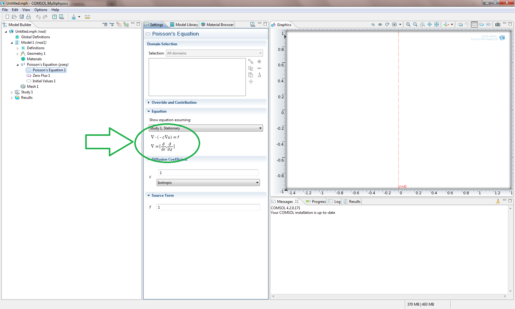

as a new user I am quite disappointed:
The geometry of the model can be defined as 2D axisymmetric, but when I add the PDE for Poissons equation to it (via PDE (poeq), the equation is not adapted to the geometry?
Which coordinate system is used in the equation? On the drawing/Geometry r and z is used, but it is not clear to me whether the equation is based on a cartesian system x,y,z , or on r,phi,z ?
How is the div (divergence) operator in cartesian and axisymmetric coordinates written in Comsol?

Posted: 1 decade ago 10 giu 2011, 10:15 GMT-4
For Poisson in a 2D axisymmetric case, you can see the equation in the Equation section of the Settings window: it tells you that the software solves \nabla . ( c \nabla u) = f with \nabla defined as (d/dr ; d/dz ). See attached screenshot.

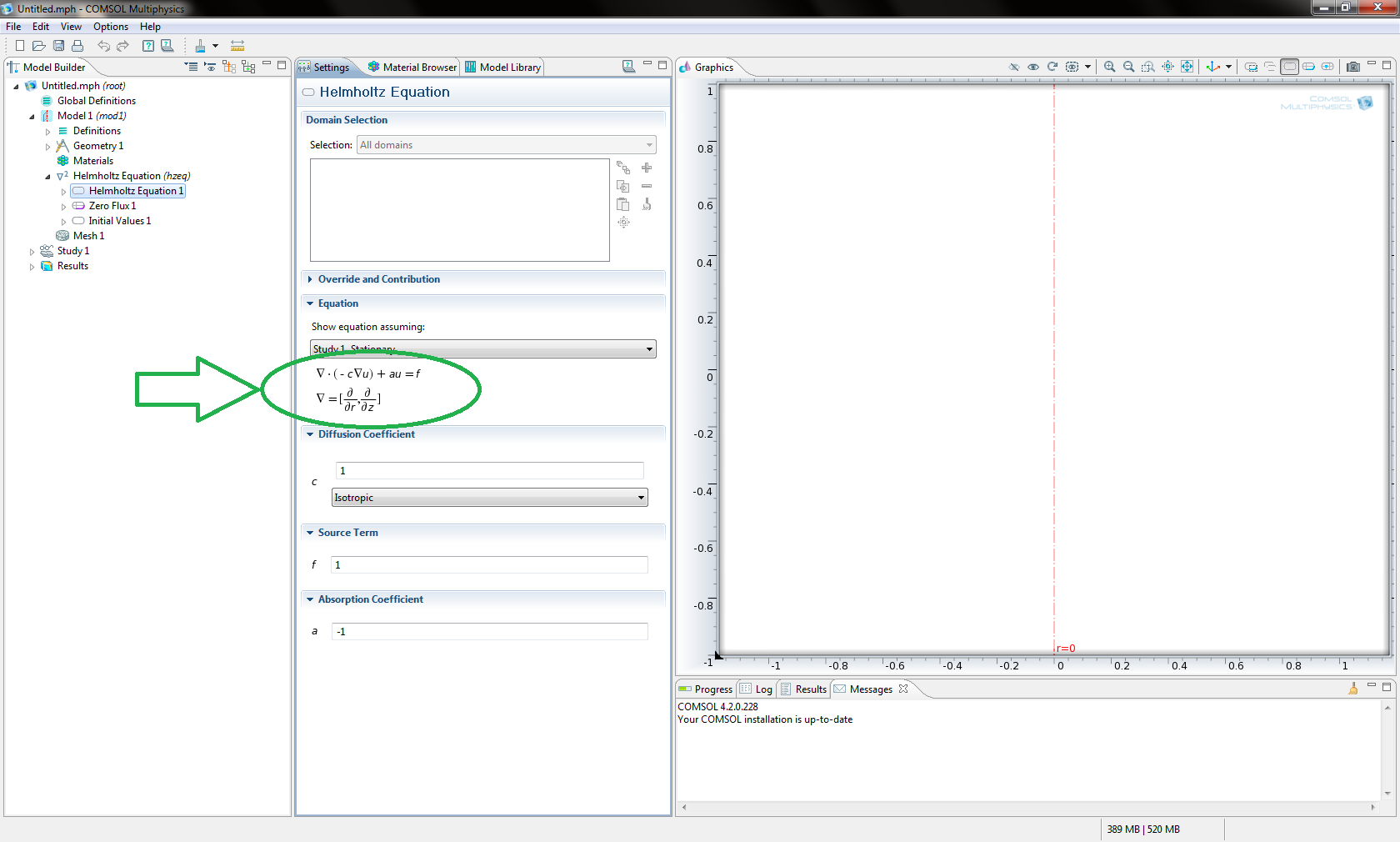

Posted: 1 decade ago 7 set 2011, 06:15 GMT-4
Hi there,
also as new user, who wasted several weeks now with on false 2D axisymmetric models, I must add that this is far more than dissapointing.
In my opinion it is by far not obvious for the common user that the program uses a different coordinate system internally than defined by the geometry. BTW: at least in the case of the Helmholtz equation the front end does not even show its internal definition of the nabla operator.
I must say, that I thought of comsol multiphysics as a really great piece of software. I mean, the front end, the live links to other programs and its huge spectrum of functionality are really convincing.
Now I must regretfully and painfully learn, that over quite some time all my calculations were complete nonsense.
It is totaly incomprehensible, why the mathematics models are not correctly implemented.
I strongly suggest to correct this flaw in future releases, because it is a completely unnecessary drawback of your otherwise fine software.

Posted: 1 decade ago 7 set 2011, 09:25 GMT-4
Hello Jan-Henrik,
I suspect you are running an outdated version of the software. In the current version, the definition of \nabla is displayed when solving the Helmholtz equation using the Mathematics interface; see attached screenshot.
Hello Jan-Henrik, I suspect you are running an outdated version of the software. In the current version, the definition of \nabla is displayed when solving the Helmholtz equation using the Mathematics interface; see attached screenshot. Jeff

d/dtheta (er) = etheta
so etheta*d/detheta (er) = 1
If \nabla defined as (d/dr ; d/dz ) then we will miss a term in an axisymmetric system when calculating \nabla . ( c \nabla u) = f
for c=1 it should be: d^2/dr^2 (u)+ (1/r)d/dr (u)+ d^2/dz^2 (u)
and not this: d^2/dr^2 (u) + d^2/dz^2 (u)
Can you please clarify on this...
Note: er, etheta and ez are unit vectors in the respective direction.
