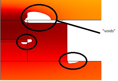

I'm working with SPS problem. This involves thermal-electric and structural deformation. I try to make the most simple case: structural in the static version. The main to problems for me are related to the structural boundary conditions and the existence of voids (white holes) in the deformed shape. This voids regions also appears if i consider only thermal and electric problem. Sorry i'm new in the area.

How are you simulating the deformation?

I'm consider the problem in the quasi-static approximation. In this case, it is better to take into account a prescribed displacement or to consider the domains and boundaries Free?
