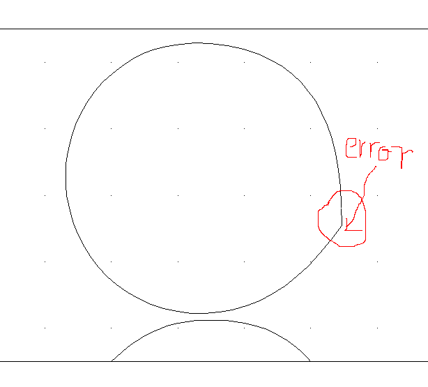

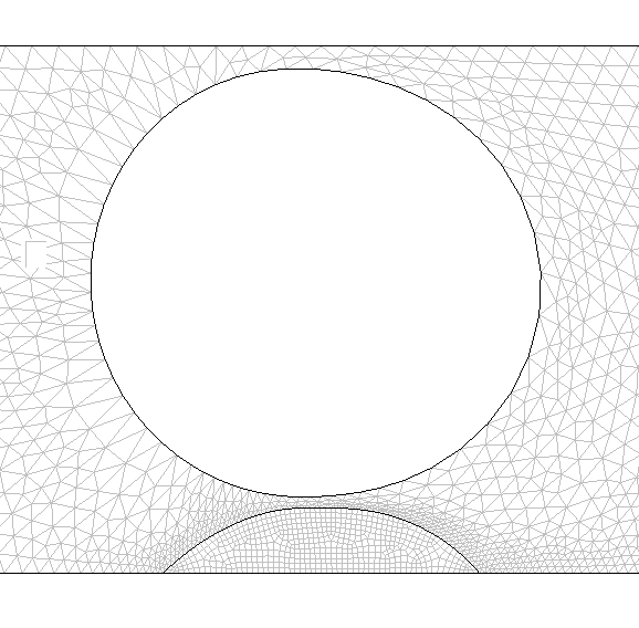

I then zoomed in this area, I found that the mesh looks fine after I click "create geometry from mesh'. However, the deformed geometry was not ok. it had a wired shape as you can see in the attachment. I looks like it is this wired point as I indicate in the attachment cause problems.

Are you moving the upper domain as well? e.g., when you are moving your structure the boundary moves, but not the domain? that would be my first guess.
Second is the way you're applying your load may create a "cavity" that is smaller than the minimum mesh size allowed on your domain. Better would be to apply it to your domain if possible, rather than boundary.
Third, since you have strong load, it is better to mesh surrounding of the boundary smaller, so there will be more mesh nodes in the moving region.
Lastly, wait for 4.2 version :) it has automatic remeshing.
good luck

Hey, Danial,
Just to update this model a little bit.
I solved this problem by writing a script to remesh meshes more frequently, as often as 5 times steps.
Although it still give me a wired looking deformed geom, the FSI problem was solved smoothly.
