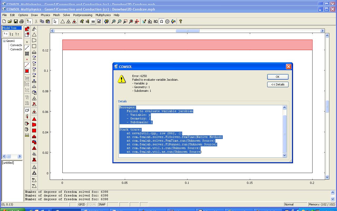

Thanks for the clue. I checked the 'Show details'. It is in the attched file. It is not clear which is the problem function. Could you have a look at it

If you tell us a little more about what you are doing you will get a better help. Just by giving in wich application mode you operate is a good clue, therefore I suggest that we all should start our calls with a [V3.5a smsld] or whatever version and application mode(s) we use, and have this in the Subject field, it would then ease the sorting for later too.
Back to your issue, if you are playing with Navier Stockes, one error we often do is to have 2 dependent variables p & T, but we define clearly ony one (T) and forget about "p" the pressure. Often to set it at one place is enough to solve the system (but sometimes we give it also at two places with different values even if physics does not allow it, typos are so quickly done ;)
good luck
Thanks for reply. To tell more about the problem, I have attached the model file.It has 2 subdomins, 1 with convection and conduction , other with convection and diffussion. There is no parameter denoted with p. It shows error with p.
Thanking you once again
