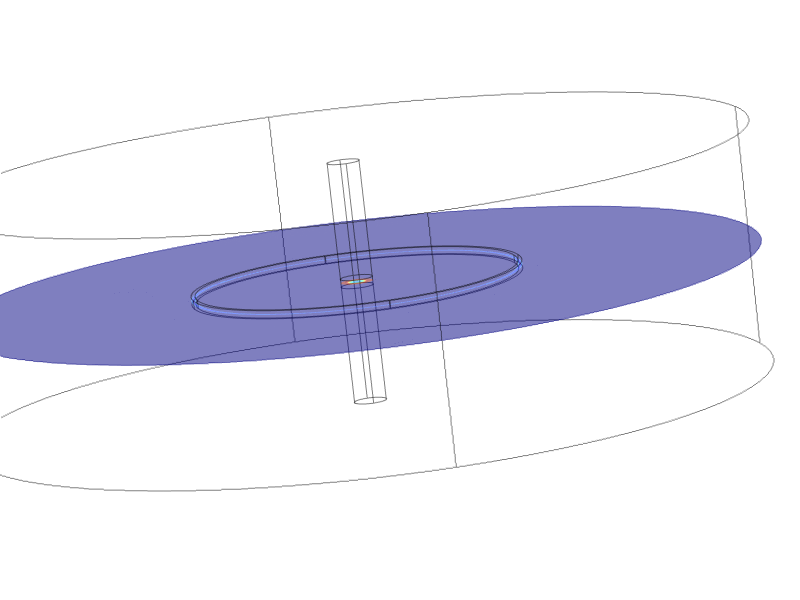

Hallo Ivar,
first of all thank you very much for your response.
To go into detail my problem is not exactly the same like mentioned in topic. As you can see in the picture 'SpgsInduktionTestSim1.png' I'm feeding-in alternating current in a conductor to check the "induced" current density in a surrounding copper wire. This simulation still works well.
But I'm more interested in a construction like represented in picture 'SpgsInduktionTestSim2.png'. To state more precisely I'm interested in the voltage induced in the coil. As you mentioned, the main problem is certainly the unclosed current circuit of the coil. There arises the question whether it is possible to fix boundary conditions (or something like this) at the 2 coil contacts to get the voltage induced in the coil afterwards.
So I hope, everything was as far as understandable.
Thank you very much in advance for your answer.
Best regards
Stephan

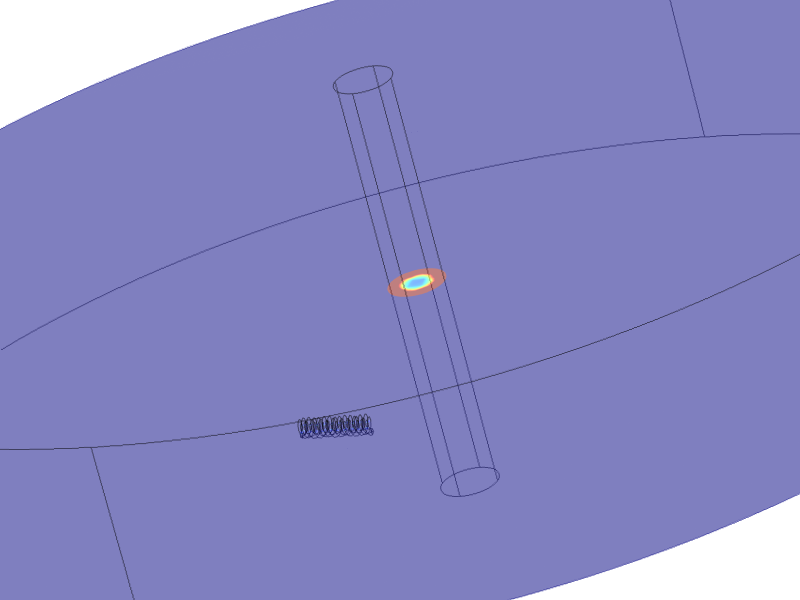

Posted: 1 decade ago 22 mag 2012, 17:34 CEST
I'm still busy with the specified problem. As you can see at the attachment I'm interested at the induced voltage between the boundaries (contacts) 15 and 16 of the coil (coil with only 1 winding). I've calculated the solution by hand but I'm not able to get the problem solved in Comsol correctly. I've read lots of topics but I couldn't find a solution how to solve this problem in 3D. As you can see in the file I tried to find a solution by line integration (Eds), but there is still a bug in it
It would be really great if someone could help me.
Thanks a lot in advance!!
Stephan

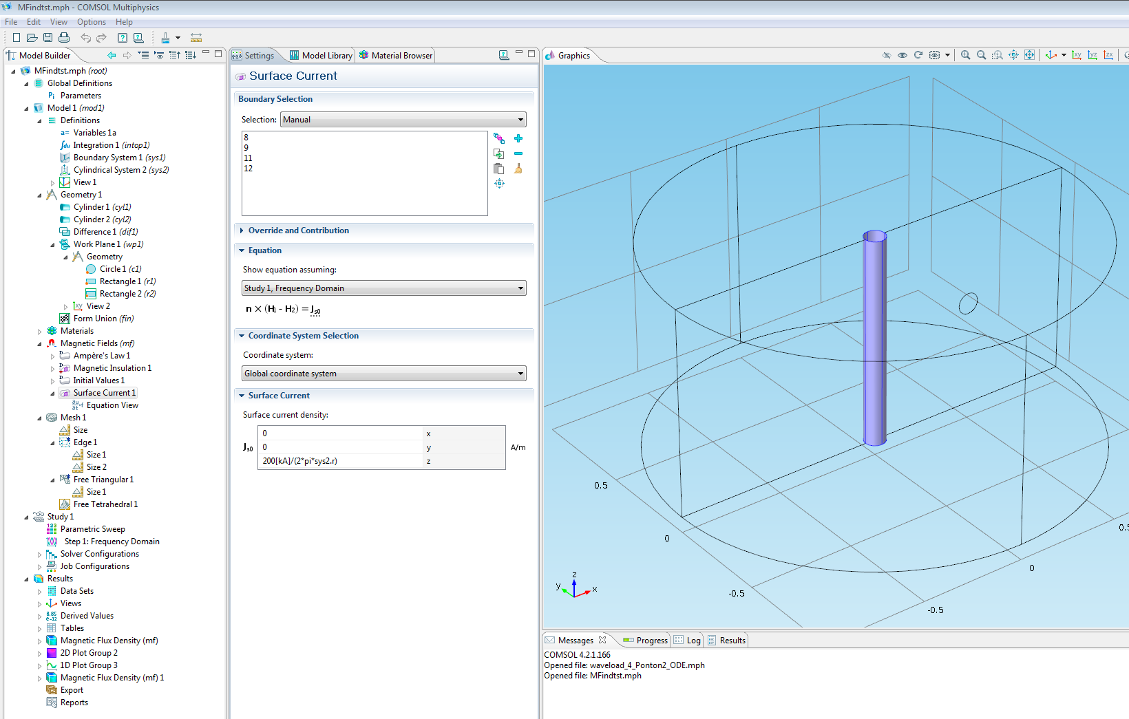

I have an example hereby in v4.2a it looks reasonable. In frequency domain you need some conductivity in air, its "just" that it must be kept sufficiently small to be realistic, it depends on the frequency to, which is rather obvious from the equations
I did it in MF as it's by far not so heavy to solve as MEF
Hi I have an example hereby in v4.2a it looks reasonable. In frequency domain you need some conductivity in air, its "just" that it must be kept sufficiently small to be realistic, it depends on the frequency to, which is rather obvious from the equations I did it in MF as it's by far not so heavy to solve as MEF -- Good luck Ivar

here is an image and the deailed reportyou might manage to redo it from here ;)
Hi here is an image and the deailed reportyou might manage to redo it from here ;) -- Good luck Ivar

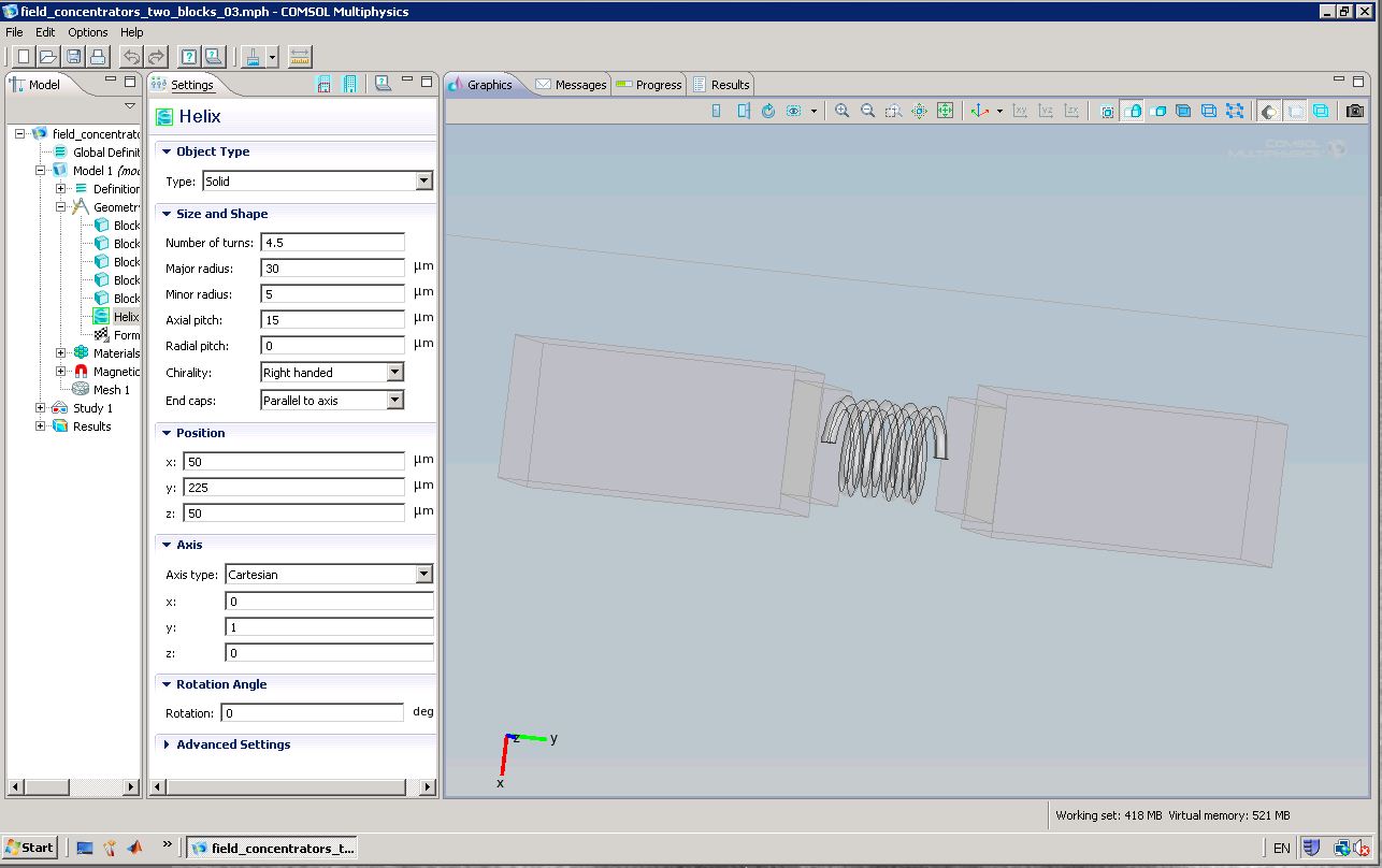

I need documentation of model in which the Inductive coupling between two coils , to find inductances of both coils , magnetic flux density , mutual inductance , coupling coefficient ...
(1) I need to fix the distances between the coils , as distance increases how the various parameters increases ..
Please provide me this documentation
Thanks in advance , waiting for favourable reply
