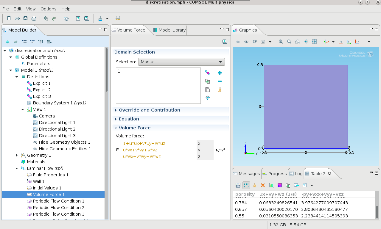

Could someone plz tell me why the text becomes yellow when I write a volume force in laminar flow module of comsol 4.3b?

when a text becomes yellow something is not correct. When you click in your text and hover over it with your mouse you will get a message stating what is wrong. In your case the units don't match.
Regards, Linda
Hello, when a text becomes yellow something is not correct. When you click in your text and hover over it with your mouse you will get a message stating what is wrong. In your case the units don't match. Regards, Linda

Thanks Linda!! :)
Thanks Linda!! :)
