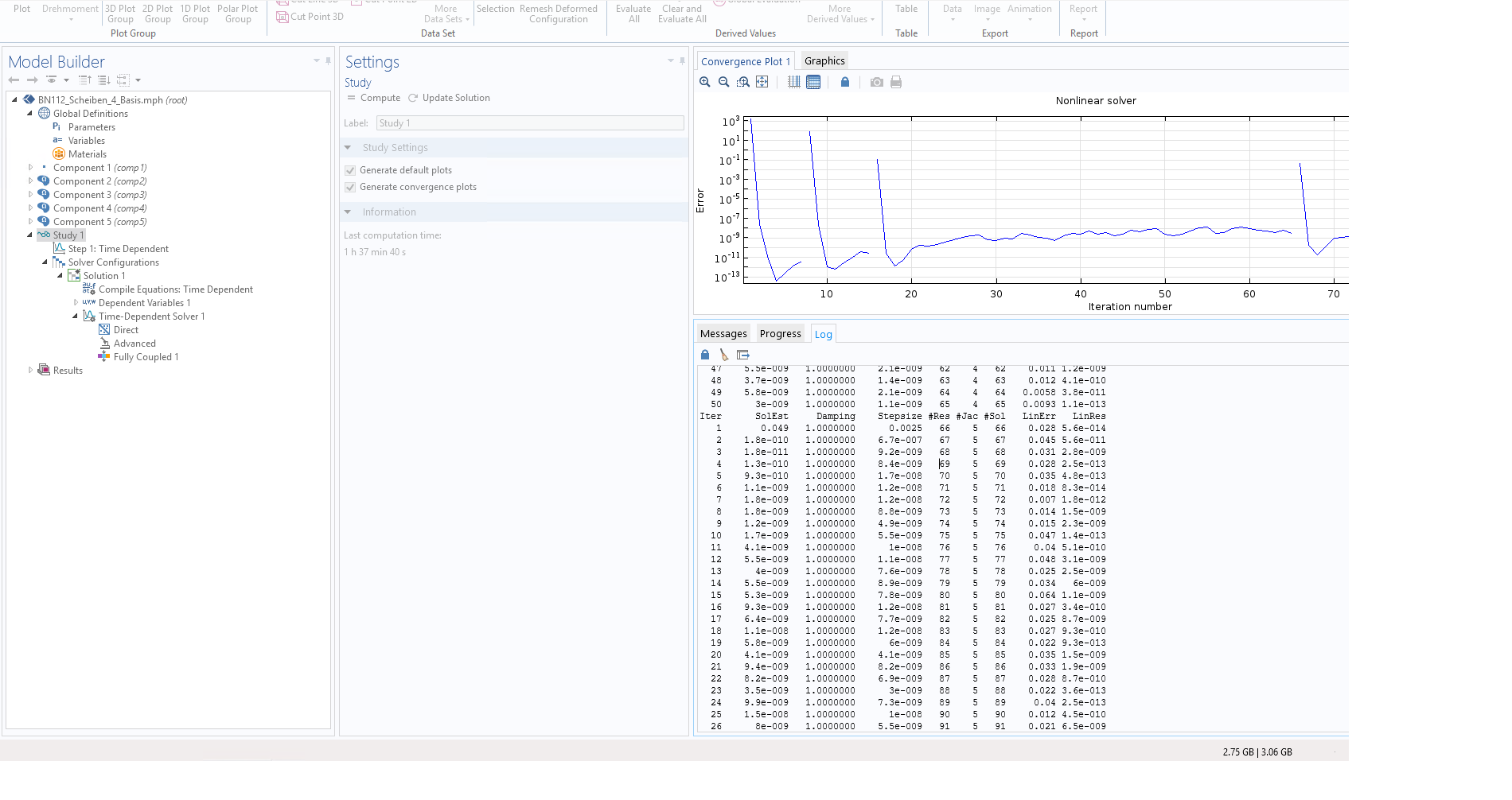

I tried Henriks tip with the Error check and the model does solve for a few time steps now (see the attached plot of the Convergence). Unfortunately, after some succesfull time steps, the nonlinear solver fails to converge.
I checked if the dependent variables show questionable behaviour. They look very smooth and not suspicious. From my point of view, the results look physically correct, but the solver says otherwise...
Kind regards,
Jan
