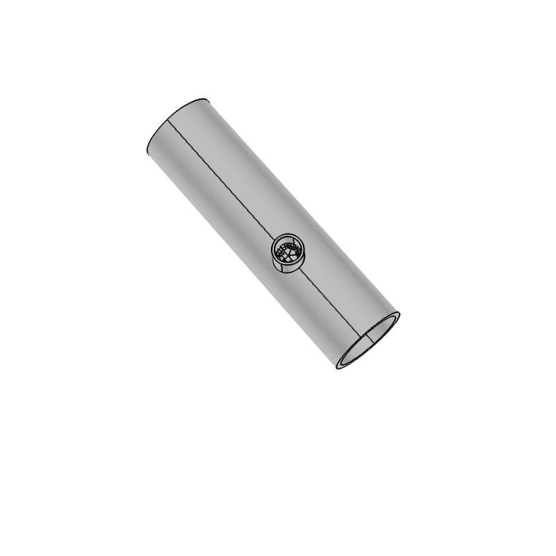

I've tried comsol and I tried to import a CAD file in step format (*.STP) created from Rhinoceros 3D export.
the model is a bog pipe which is crossed by a smaller one and the model looks like a T. My problem is that the common section between the 2 pipes is a hole on my model and in comsol multyphysics after being imported, this crossed section is filled with littles surfaces.

I have no problems with CAD import, provided I import solids and not shell surfaces, as these are not easy to knit correctly together (neither for COMSOL nor for any other programme), I suspect that in your options you have a surface and not volume export option active
Hi I have no problems with CAD import, provided I import solids and not shell surfaces, as these are not easy to knit correctly together (neither for COMSOL nor for any other programme), I suspect that in your options you have a surface and not volume export option active -- Good luck Ivar
