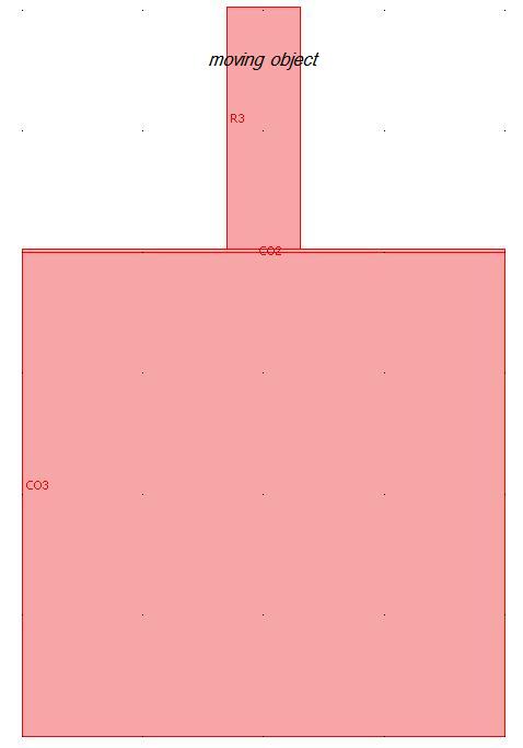

                                                Posted:
                                2 decades ago
                                1 feb 2010, 12:33 GMT-5
                                                    Hi Ivar,
I have the following problem if you can help me:
I am trying to build a model of one object that moving with different speeds and come in contact with other object (see attachment), what i want to know How can i model the object to move with different speed and how can figure out the Vonmises stress during the simulation
Thanx
Ali
                            Hi Ivar,
Thanx
Ali
