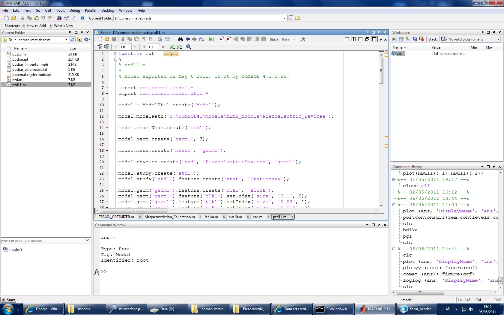

a) Save your model in COMSOL as a matlab file. Then open this file with a "Matlab with COMSOL41" session. You will be able to find how the model is set and you can make your own change there.
b) Add a parametric sweep node in your COMSOL file, save your file as a Matlab file and look at the new code that has been generated compared to the previous script without parametric sweep.

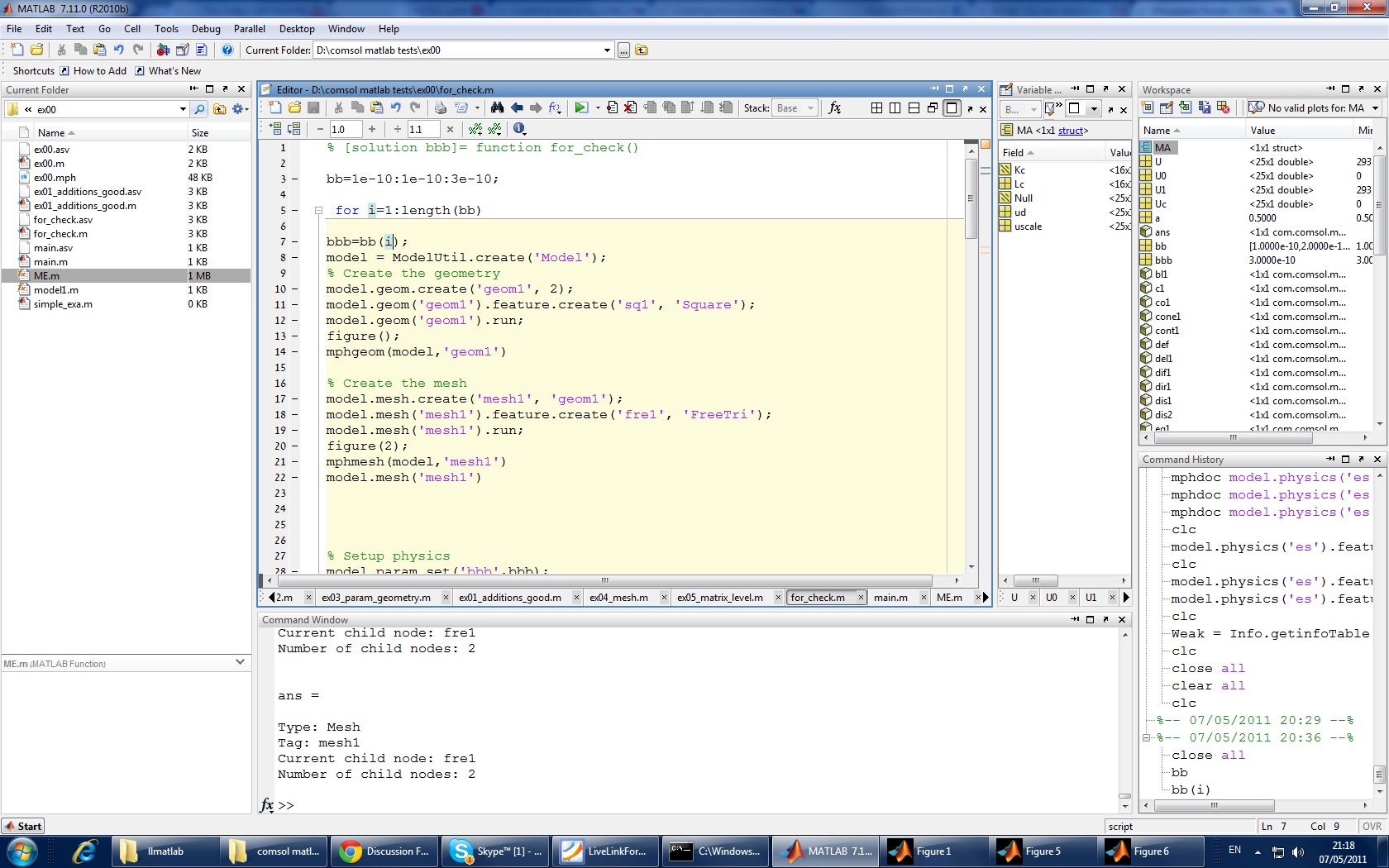

now my question is:
if it is possible to run my model as like it was a function
attached
for I.e the picture show i have a for in my model
but i want the for to be outside the model and to run the model
as if it is a function that the for is calling for it
Arye
