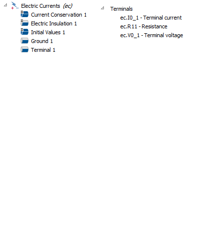

Hi there, Everybody keeps asking this question but still no any simple answer here or anywhere alse, How such powerful software can't measure resistance between two points on the wire like simple multi meter can do. If this is EC simulation stationary or time dependent. Can somebody show how to set up resistance measurement between two points in few clicks, without formulas or manual calculation, just want to pick up two surfaces and click "measure resistance". Thanks!

Nic,
You can use Terminal boundary condition to calculate resistance between two surfaces, as shown in the attached image.
Regards, Sergei
