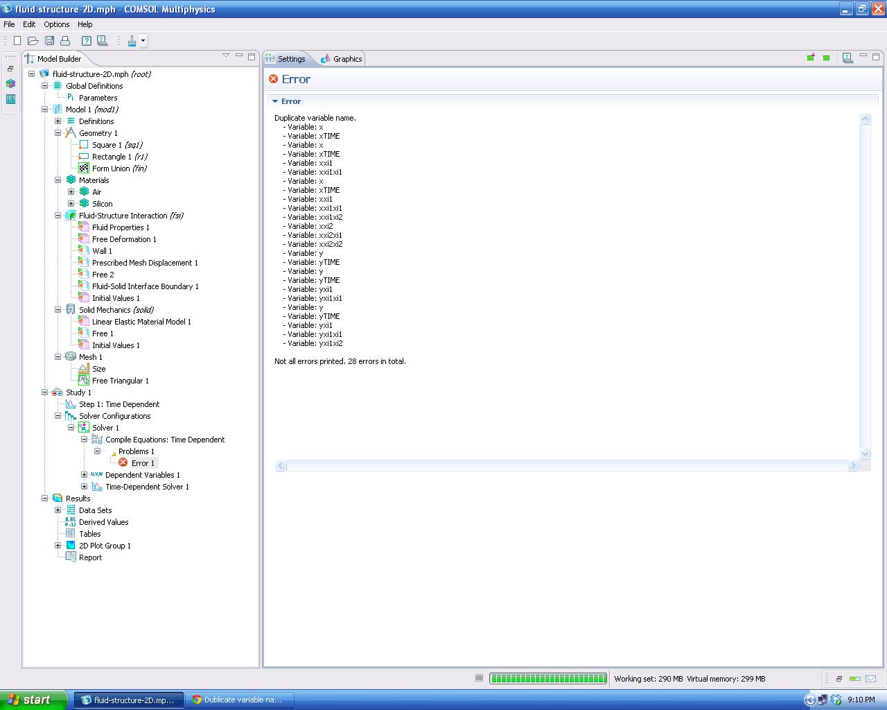

it's most probably because you have FSI which contains "structural solid" physics and "Solid" physics in the same model. You are duplicating many features, and if you do not use different dependent variable names you might get "duplicated names" error. Still the names on the list are puzzling, they are coordinates and not dependent variables.
Anyhow, with FSI normally you do not need to add solid, as its already contained in FSI, under subsection Structural

                                                    I've decided to just use FSI. Now I get this error : "Failed to create temporary file on server." Any ideas?

COMSOL automatically identifies the boundaries that form the fluid-solid interface. In the model both domains seem to be defined as fluids. A first step here is to add, for example, a Linear Elastic Material Model node to domain 2 to represent the solid. The boundary selection in the Fluid-Solid Interface Boundary node is then updated to include the four boundaries that separate the solid from the fluid.

                                                    I appreciate all the help. I have one more error: "Failed to find consistent initial values.
Last time step is not converged." My initial conditions seem to be ok. Might it be something else?

I am getting the same error (but 42 errors instead of just 28) when I involve "ale" in simulating the basic electrostatic actuation problem of a cantiever. Is it possible to help me get rid of this message?
I downloaded a file from COMSOL called "ale_cantilever_beam_3d", and I just follow what it does with my own switch (except for the symmetry part), but I keep getting the error message described above. In fact, I use Moving Mesh, Solid Mechanics and Electrostatics modules together.
