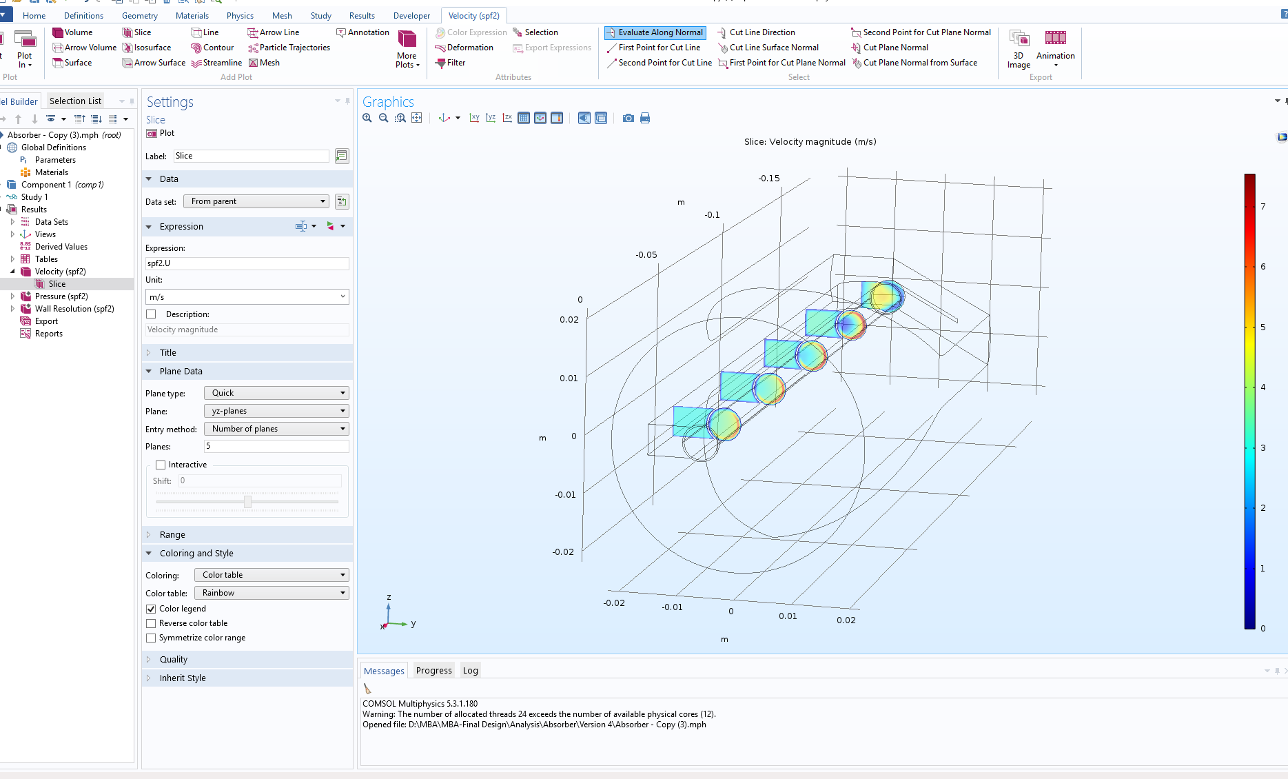

I was just curious if others are having the same issues as I have been having with 5.3a. My first issue is that I will solve a problem. When I go to do post-processing everything will seem fine, but if I change the variable I am processing the screen locks up and I lose my solution. I know that sounds odd, but I literally lose the solution. The file size even changes! (see images, picture 1 shows the solution, picture 2 shows what I get when I try to view the turbulent viscosity, picture 3 shows my velocity profile when I go back to the velocity plot)
