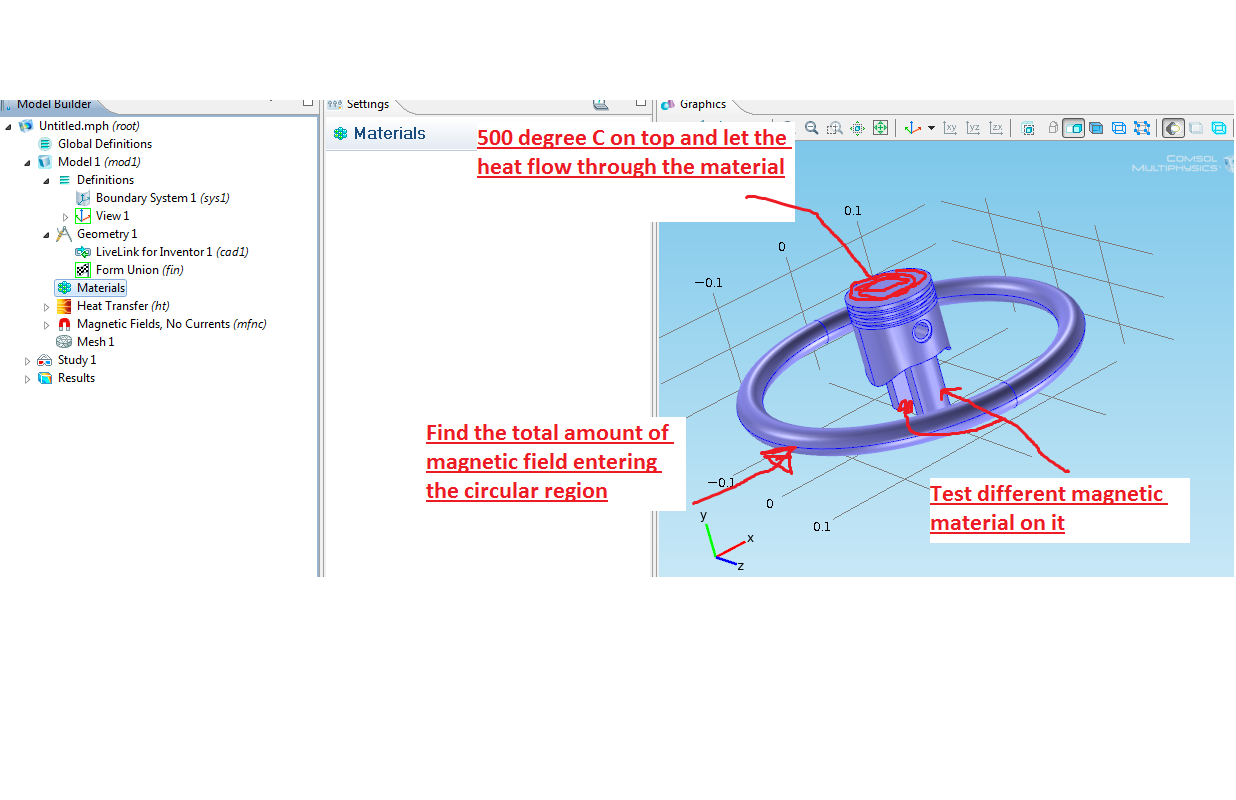

Also, is there a way to show how much of the magnetic flux is cutting a coil of wire around it??
well chose MF, stationary , draw your magnet (centred at 0,0,0), surround it by a sphere of radius >3-4 times your magnet, add a 1/10 radius shell on your sphere (in v4 you have the layer) call it a Infinite Element layer, add a "Ampers's Law 2" and select the magnet. Set the Magnetic field tab to Magnetisation and type M =1E6[A/m] (or whatever you need) for one direction. Do not forget to add the material air: sigma = 1, epsilon_r=1, mu_r=1 and the magnet sigma =1, epsilon_r =1, mu_r =1.1 (or whatever material properties that fit)
Then solve, you may test with or without a Inf Elements. To integrate the flux you might either Data set cut surface and integrate over it, or you add a dummy body(ies) of "air to define your relevant surfaces, and then you might pick the boundaries and integrate over them. By the way use spherical Infinite elements! this with a sphere is not the default

But I have model made in inventor on which i want to carry out the simulation on.
The CAD model is attach. Can you please help me step by step how to perform the test?
What I want to do is simple, 400 degree celicus to be on top of the piston head. The bars sticking out in the bottom of piston are the magnets. I want to see the the change in magnetic field, flux density and strength of magnetic field about 10 centimeter away from the central axis of the pistion. I have to calculate induced voltage.
I need to test the simulation with different permanent magnets.
