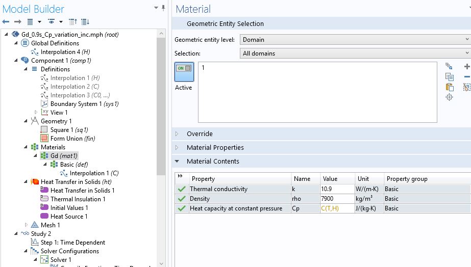

Hello people, I have a problem. So, I'm trying to enter Cp(specific heat) as a function of two variables-temperature and magnetic field. Cp as a function of T is accepted under the particular material properties. But when I enter 'Cp(T,H)' it turns orange and says H is an unknown variable.

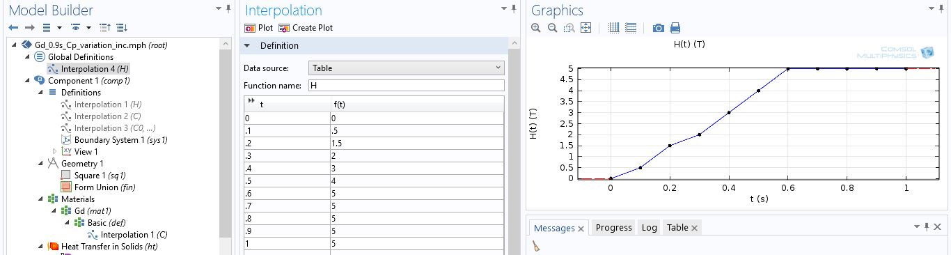

I have defined H as a time dependent interpolation function under Global Definitions.

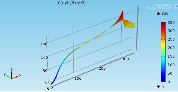

And for Cp, I have defined it as an interpolation function depending on 2 arguments(temp and mag. field). I've input a txt file for this purpose.
I have attached the figures for reference.
