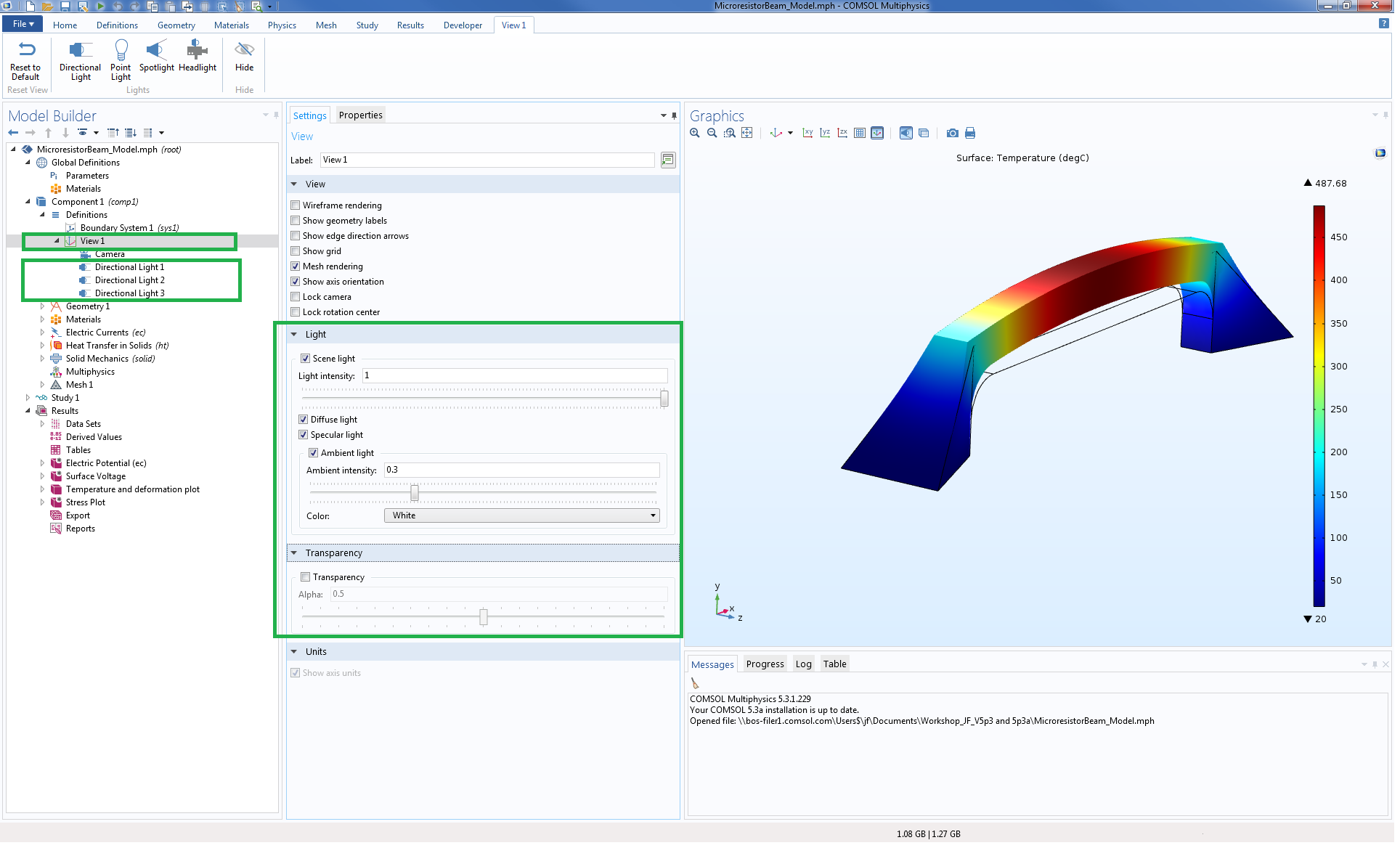

Thanks for the support, but I can not agree. For example, I can not change the transparency level, I can not set the edge color and so on. When you talk about "more options under the View node's Light tab", are you really talking about options related to lighting/reflectance? I use comsol on linux and I can only turn on/off Scene Light. Something else?
Posted: 8 years ago 29 mar 2018, 11:06 GMT-4
See attached screenshot.
Jeff Hiller
See attached screenshot. Best, Jeff
