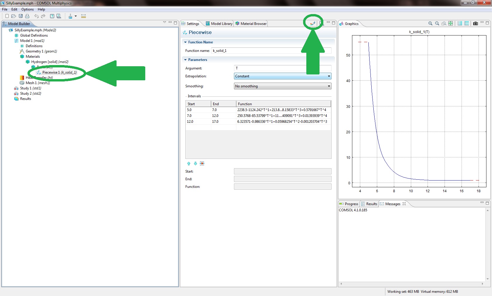

See attached screenshot.
Is there a way to export and save the material property data in the plot ??
[QUOTE] See attached screenshot. [/QUOTE] Is there a way to export and save the material property data in the plot ??
