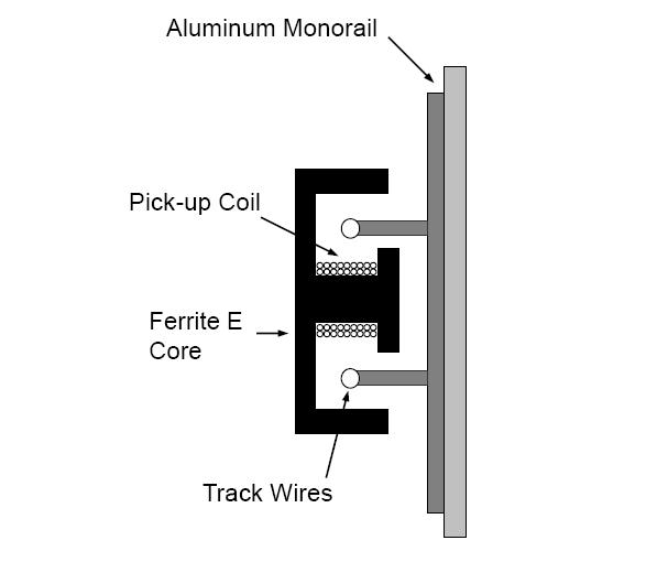

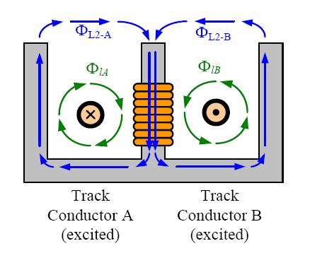

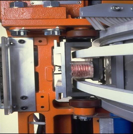

To make a better understanding of the system that I'm trying to simulate I have attached some illustrations that I found on the internet.
