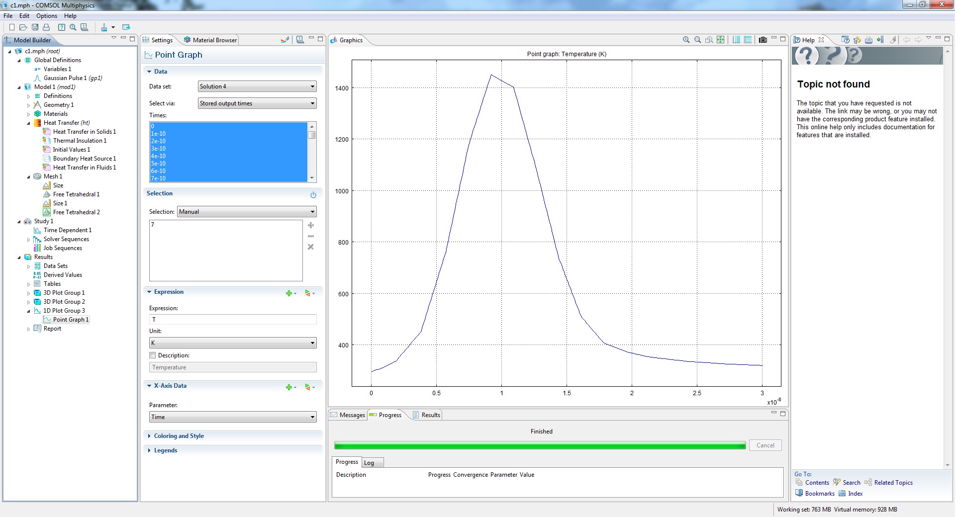

When I plot my results using the 1D Plot Group, Point Graph, I get a jagged curve as opposed to a smooth one. (see attached file).
I have tried changing the time step of the model (making it smaller) and refining the mesh but I still get the same curve.
How can I obtain "smoother" results?

what do you have as time stepping, is it automatic ? or strict, or intermediate ?.
For pluses or periodic shapes you should NOT use automatic as this is tailored for diffusion or asymptotically trend solutions
Hi what do you have as time stepping, is it automatic ? or strict, or intermediate ?. For pluses or periodic shapes you should NOT use automatic as this is tailored for diffusion or asymptotically trend solutions -- Good luck Ivar

It looks like you may not have updated your plot after running the simulation with the 1e-10 time steps.

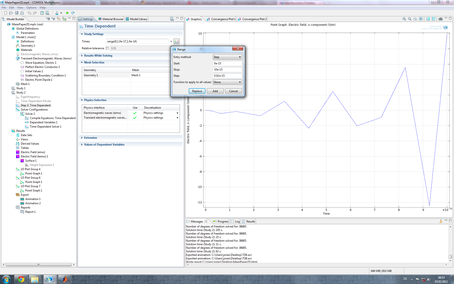

I am having the same problem, and dont know what could possibly be the reason, ive definately redrawn and tried different settings for the 1D plot.

can you attach the model file .. i want to have a try at it ?
Posted: 1 decade ago 3 feb 2012, 09:30 CET
Thanks,
and if you could also tell me why my source is oscilating so irregulaly, I would be very greatfull!
Thanks, and if you could also tell me why my source is oscilating so irregulaly, I would be very greatfull!

there are several points I can comment:
Trick for the geometry rectangle, in V4 you can add a or several "Layers" and apply it on all boundaries, this reduces the 4 rectangles into a single rectangle call, far less to click and to take care of
Gold, your epslion seems strange, you need at least an "j" or "i" for the imaginary part, then check your sign convention, there are two around COMSOL uses the "-" one
Then check your doc if all these physics solve for sigma = 0, often its better to give al little conduction to air 1S/m or so, and gold is definitively not "0" for sigma
Your time solver, if you check the log file you see that COMSOl solves several steps, then it gets to the time to extract your demanded valaue = "out" then it solves a step again etc, but towards the end it has made a large step and your results out are all interpolations froma few solver steps hence strange behaviour.
You should use a more restricted solver stepping, in the Time Stepping tab of the Transielnt solver node change "free" to intermediate or strickt (Steps taken by the solver:)
And take some tome to read and re-read the doc, its worth it ;)
Hi there are several points I can comment: Trick for the geometry rectangle, in V4 you can add a or several "Layers" and apply it on all boundaries, this reduces the 4 rectangles into a single rectangle call, far less to click and to take care of Gold, your epslion seems strange, you need at least an "j" or "i" for the imaginary part, then check your sign convention, there are two around COMSOL uses the "-" one Then check your doc if all these physics solve for sigma = 0, often its better to give al little conduction to air 1S/m or so, and gold is definitively not "0" for sigma Your time solver, if you check the log file you see that COMSOl solves several steps, then it gets to the time to extract your demanded valaue = "out" then it solves a step again etc, but towards the end it has made a large step and your results out are all interpolations froma few solver steps hence strange behaviour. You should use a more restricted solver stepping, in the Time Stepping tab of the Transielnt solver node change "free" to intermediate or strickt (Steps taken by the solver:) And take some tome to read and re-read the doc, its worth it ;) -- Good luck Ivar

thanks for the hints, the layers trick is handy.
and I clearly screwed up my metal.
now do I understand the time stepping settings correctly in, that if I use the strict it will use strickt discrete timesteps and not as is now the case interpolate between vast time regions?
Ive been (re).reading many tutorials, but most I feel focus on very specific tasks while I am often still trying to figure out where top and bottom is. If you have any specific suggestions they would be welcome:)

anyway it would appear your tips helped, it seems to be working now, so its very much appreciated :)

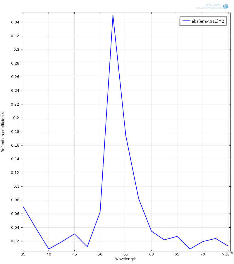

Hello all,
I am getting sharp peaks instaed of smooth curves .I followed some of your suggestions ,but i coudnt get the desired result.Could you please look into my model.It will be very helpfull for me .Thank you.
