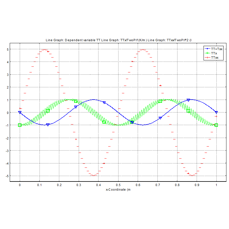

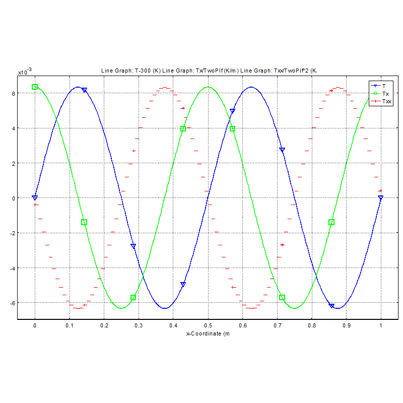

In v4.1.0.85 it gives this:
OK up to third derivative, 4th has a scaling issue ?
each derivative is divided by 2*pi*freq for normalization.
Why is TT=PDE of Txx renormalized to 1? ===> it's not, I was too quick, I forgot about my renormalization ;)
But why is TTxx at *5 the expected amplitude ===> not understood
Having (less?) fun COMSOLing
indeed, the 4th derivation is too high (approx. 5 times). If I switch to quartic elements for 'T', there is no 'scaling' issue anymore. -> Txxxx/((2*pi*f)^4)=T
So it's a numeric issue?!?
That's what you mentioned?
Having (even more!) fun COMSOLing ;)
