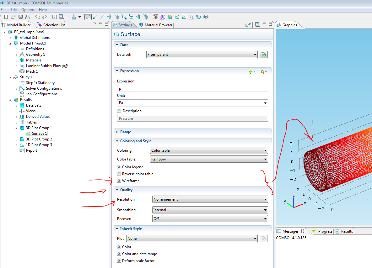

I do not have any Quality option in the node menu.

I do see below
Hi I do see below -- Good luck Ivar
