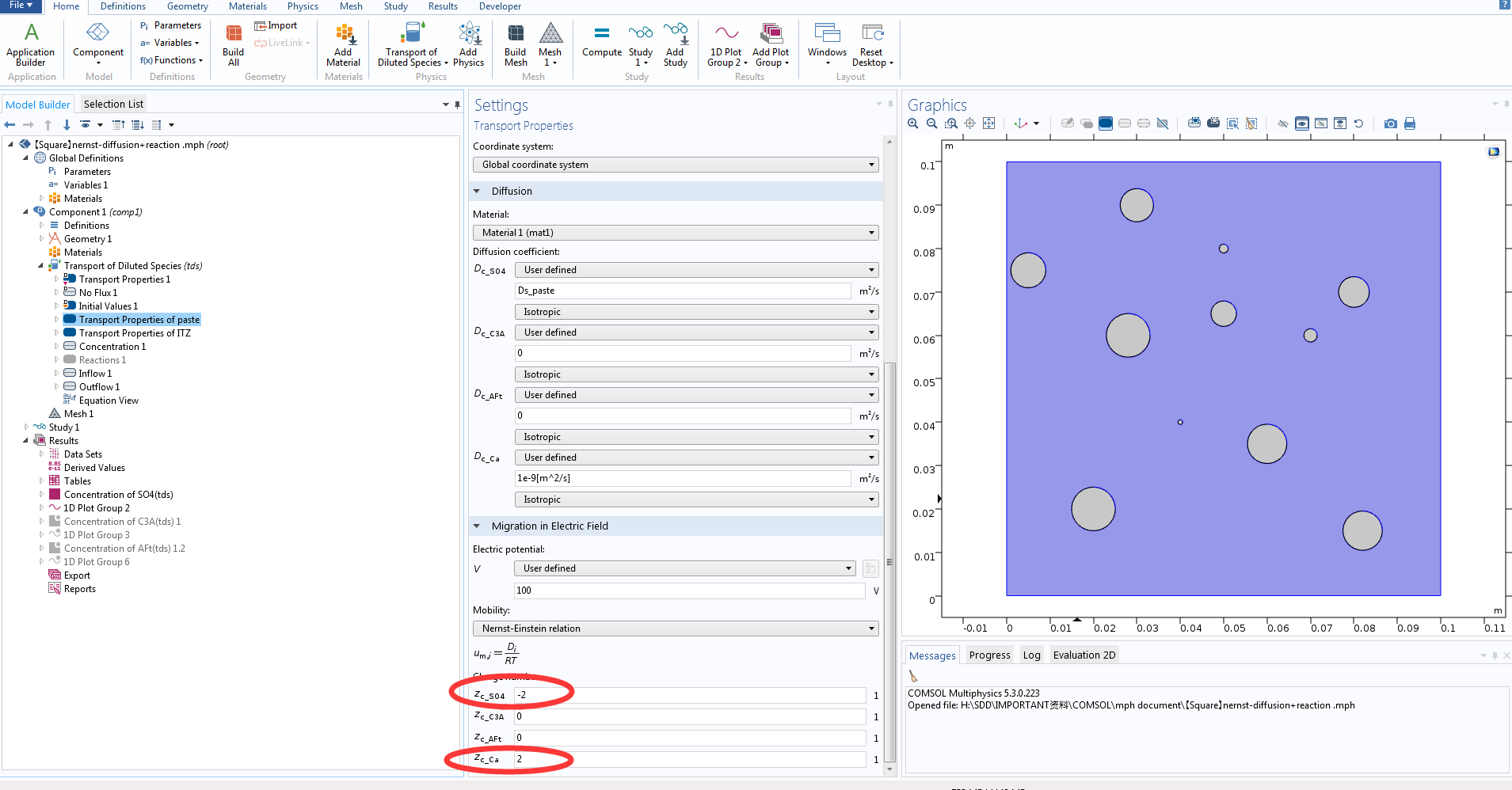

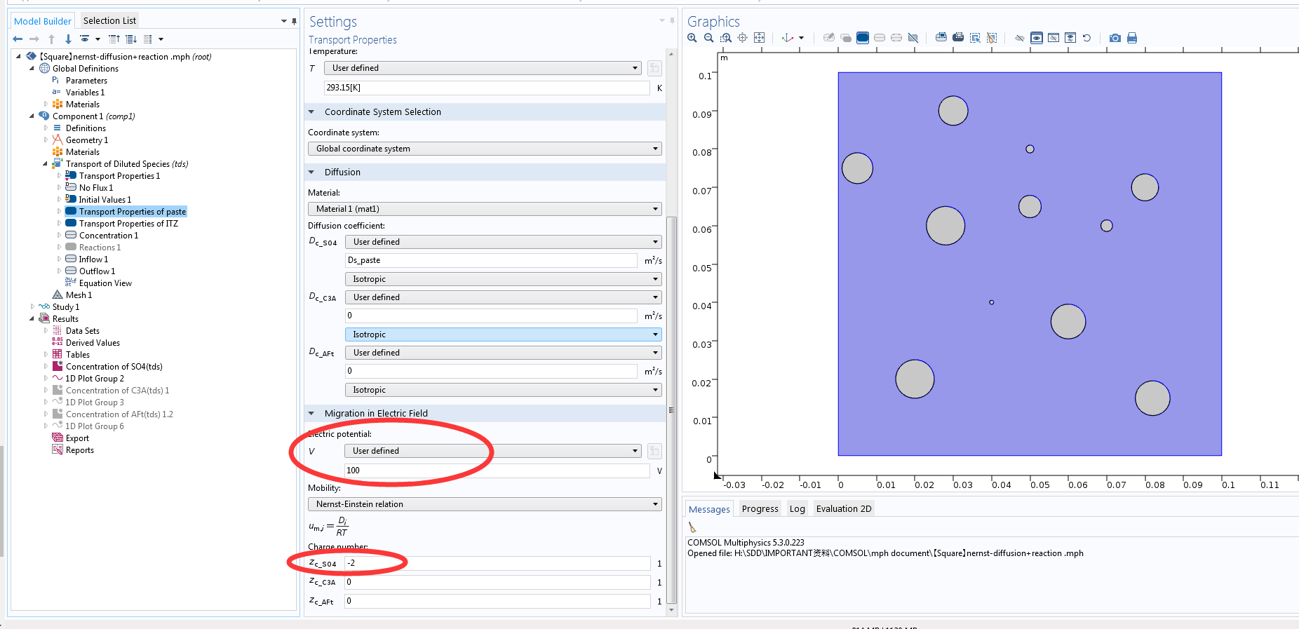

                                                    You have only one electroactive species, which violates electroneutrality. You must add another ion, a counter-ion, a cation in the system. This applies also when the other ion is not actually moving (steady-state).

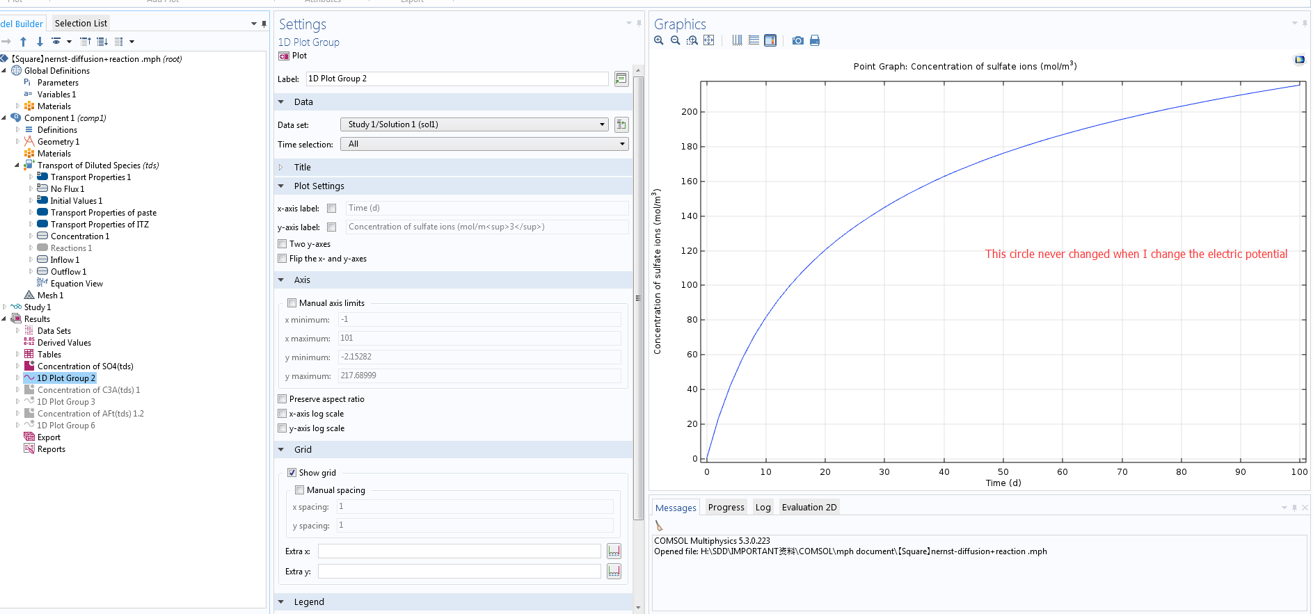

                                                    Thanks for your answer. I've tried this method but it still doesn't work. The curve of the concentration never changed no matter how large the electric potential is.

                                                    A constant potential does not cause migration, an electric field is required.

                                                    So should I  add an Electrostatic physics field? Because adding an electric fied under migration option of Transport if Diulted Species doesn't work.

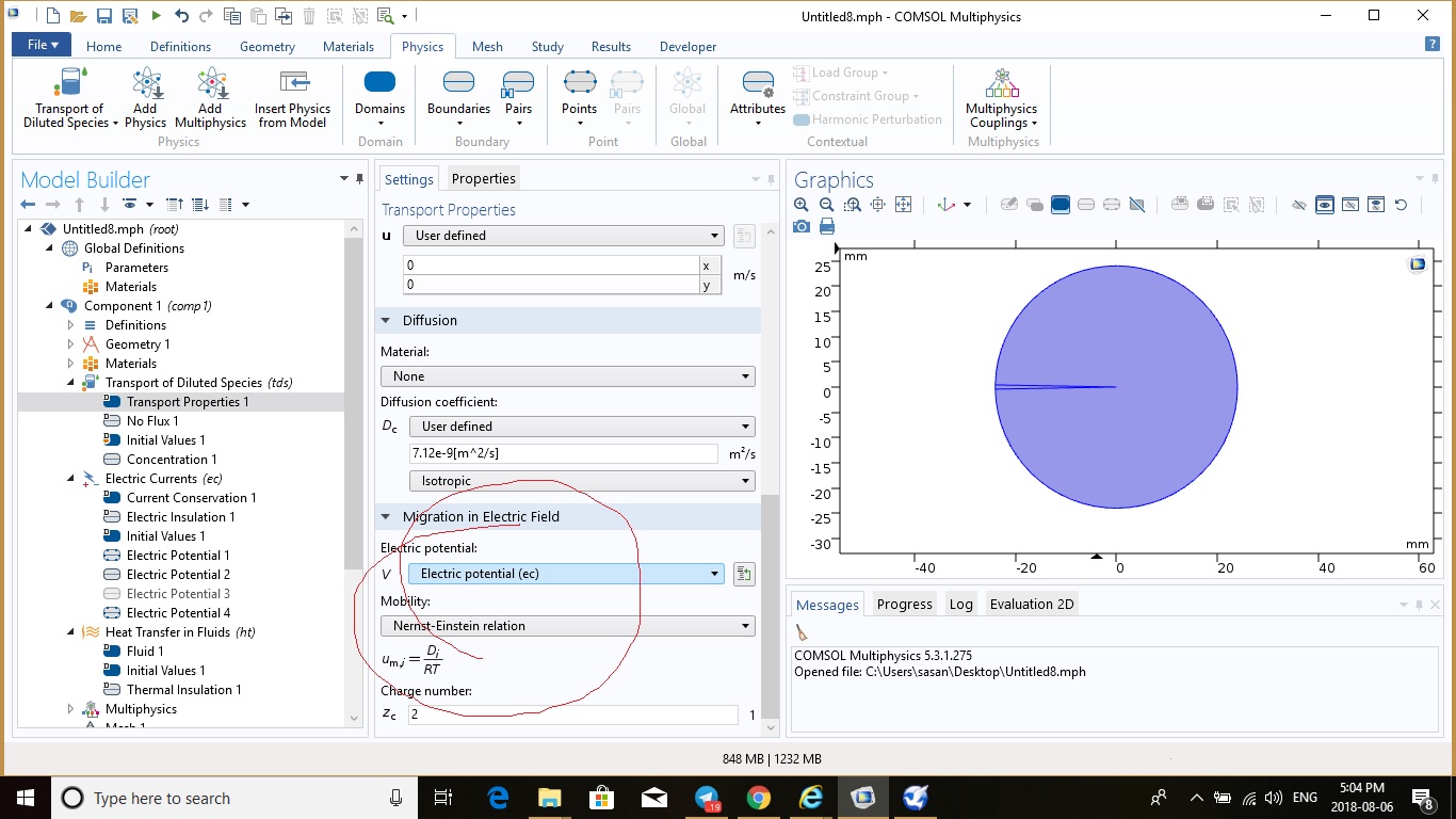

You should also activate electric currents module.
furthurmore, in transport of diluted module, you should use electric potential instead of user defined option in section of Migration in electric field.
you can also view the attachmant.
