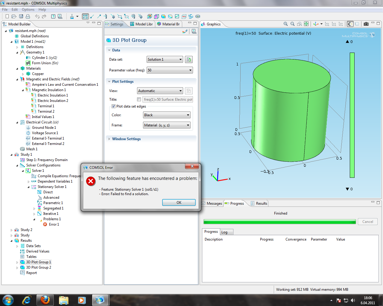

I can´t even normal resistor connected to a power source, some error comes all the time, see attachment.

I built a simple model of resistance of MEF module and I tried to connect the AC power source to resistor.
Please, could you tell me what is wrong with it ?
I just can not be connected to the scheme of model. All time same error comes. How difficult can it be ? :)
If you look at this model and correct the error could you please send it back to me. Then I can perhaps understand how to combine the model and scheme.
