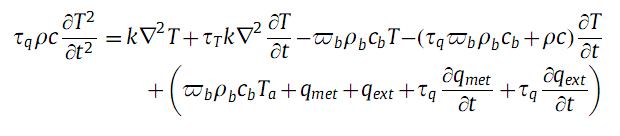

I have attached my DPL bioheat equation. I want to define this equation in coeffficient form of comsol 3.5. Can you suggest me how to dfine it in comsol (espacially the non-linear heat flux gradient term in right hand side of the DPL equation attached here).
Please help me with your comments.

what are the boundary conditions for your problem?
Moreover, I think that the General form PDE should be better for non linear partial differential equations
Hi, what are the boundary conditions for your problem? Moreover, I think that the General form PDE should be better for non linear partial differential equations

Hi Francesco
I have taken the two boundary condition conditions(Neumann and Dirichlet). The problem is how to define the extra gradient flux term in the general PDE equation.Please look at the attached fife.There is an temperature gradient term multiplied by thermal conductivity and relaxation time in DPL Bioheat equation I have defined as diff(del^2(T),t). Is it correct?
Thanks and Regards
