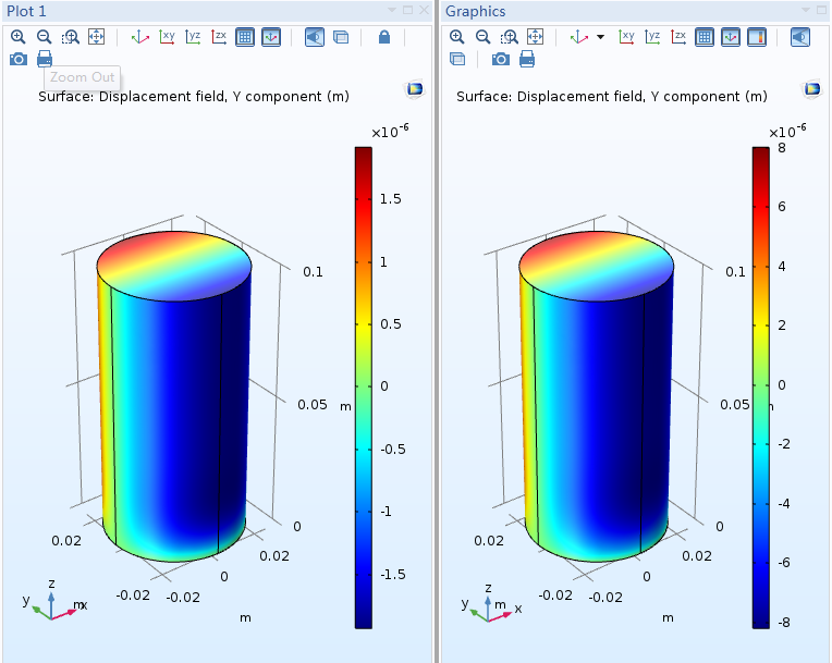

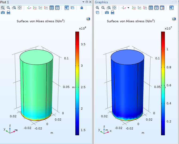

Posted: 7 years ago 18 dic 2017, 08:24 GMT-5
Dear Henrik,
Thank you for your kind response. I get it. I 'm plagued by another problem.
I have rewritten the linearelastic.c program of the example for it can be used to the transverseisotropy Material. There is five input arguments and the D matrix is different from isotropy material. See the appendix in detail.
But there are some differences in the results bettween calculated by External materials and direct calculated by orthotropic elastic. Such as mises stress and strain component. See the appendix in detail.
Dear Henrik, Thank you for your kind response. I get it. I 'm plagued by another problem. I have rewritten the linearelastic.c program of the example for it can be used to the transverseisotropy Material. There is five input arguments and the D matrix is different from isotropy material. See the appendix in detail. But there are some differences in the results bettween calculated by External materials and direct calculated by orthotropic elastic. Such as mises stress and strain component. See the appendix in detail.
Posted: 7 years ago 18 dic 2017, 08:59 GMT-5
This is the .c program appendix.
