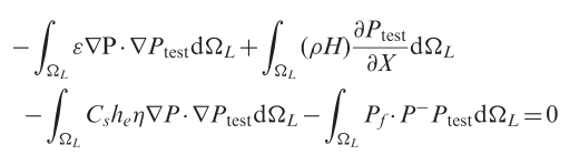

Hi, Can someone help me with implementing equation(img1) into Weak form PDE? I need integrate equation over the surface. Do you think that this is right?
-epsilon.PTxy.test(PTxy)+dens.H.test(PTx)-Cs.he.visc.PTxy.test(PTxy)-Pf.Pmin.test(P)
