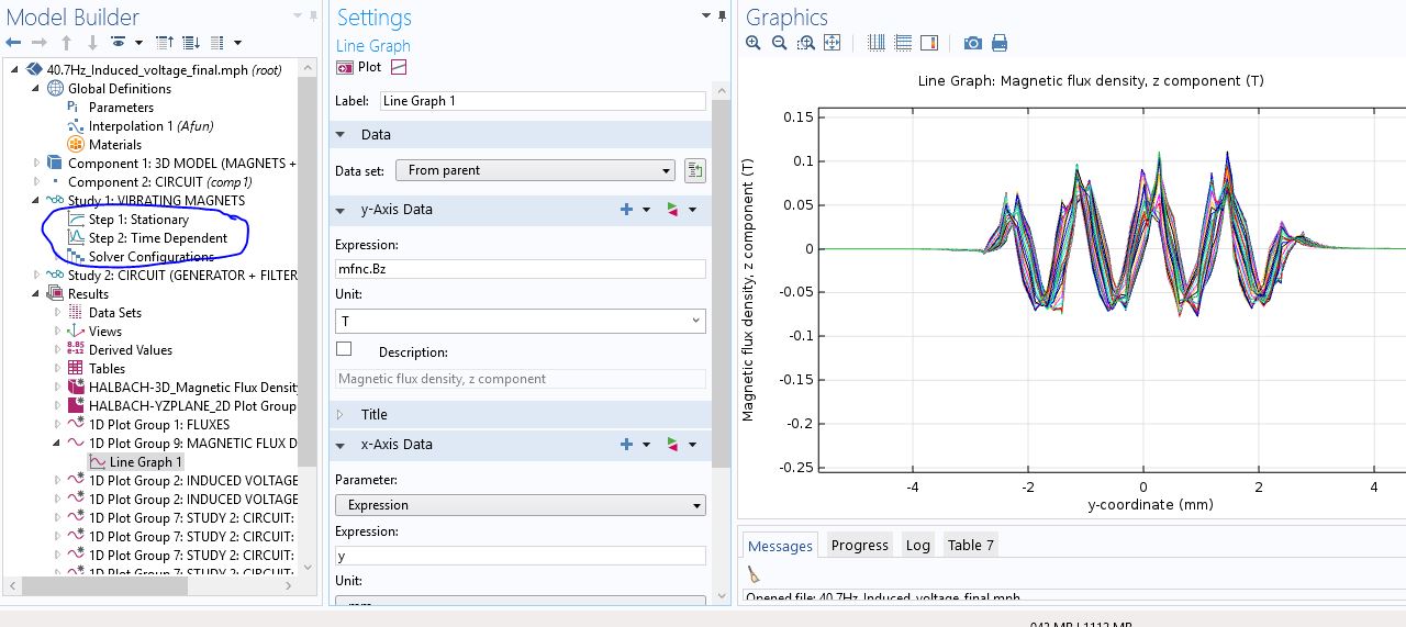

Thank you so much for your time. Actually sir you didn't followed my issue. Let me show you screen shot. As you can see in the picture someone added step 1 and step 2 in the study 1: Vibrating magnets. Can you help me how can i add these 2 steps ??

Hello Asad,
If you currently have a blank study, i.e. one without any step, then follow the procedure I described above twice, once for each step you want to add. If I am still not understanding you, please consider contacting COMSOL support at support@comsol.com .
