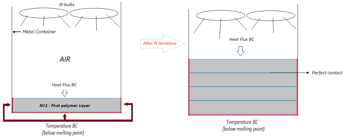

I am simulating the heating of a polymer layer by INFRARED bulbs taking into account a partial phase change (Enthalpy method) from solid to liquid phase. Then after the cooling, I want to add another layer of the same polymer with the same properties and thickness and re-do the same operation of heating and cooling until I have completed my N-layer model.
Until now, i succeeded to simulate the heating of one layer in time-dependent mode, The TRICK is I don't know how to implement the geometry build-up in each iteration and how to force the solution of layer "N" to be the BC for layer "N+1"

Please find attached my model (N-layer polymer.mph) and an image (concept.png) describing what I am trying to simulate here.

I think I underdstand your problem, the thing you have to do:
1) Solve your first iration, only with the 1 layer geometry (save your model as .mph)
2) With the same model still opened: add the next layer of the geomtry and add an initial condition for the temperature, set this init2 with the value "T" and apply it to the first layer
3) Apply init1 = 255.15 K to the new, second layer.
4) Go to Solver 1 > Dependent Variables > and set: Method to "Initial Expression" and set Solution to "Solver 1"
5) Solve it again and repeat steps 2, 3 and 4 untill your done.
In my opinion, that is the way to go.
