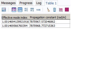

  1. The two modes are very close but they are not the same. You can use "Full Precision" option in the "Global Evaluation" to see the difference, as shown in the attached table.

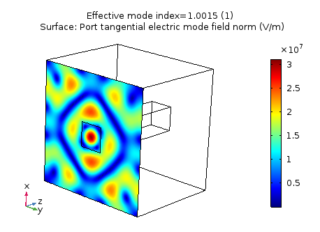

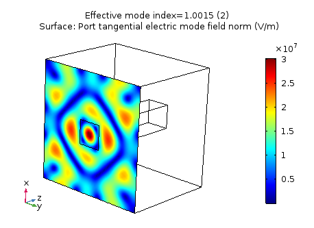

  2. There are predefined variables from the Boundary Mode Analysis step which can be used to visualize propagating modes for each effective index, as shown in the attached images.
  3. To lunch specific mode, just use full precision of the effective index, as illustrated in the attached mph file.
Sergei
