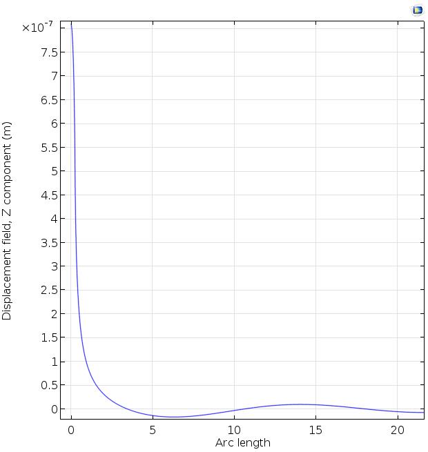

Hi guys, I have a question. I want to simulate a harmonic boundary load with a constant frequency at the surface of a elastic half space and find displacement amplitudes at the surface of the half space. Can I use the frequecy domain study? If so, I have defined a boundary load on the surface and set the frequency on 10Hz in the study part. After computation, I have vertical displacements (w) along a radius line from the load center. What does this plot mean? I mean, what is it showing as the displacment for each point? It looks like at some points I have zero displacements but It is not reasonable. Please help me. I think I could not understand the frequency domain.
