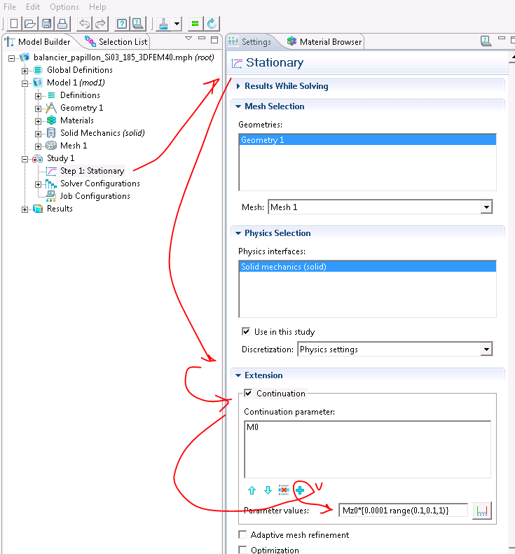

Thank you Ivar. Is this in the Study Settings, under Continuation parameter?
I really appreciate all your help!

I would say so, take a look this is for a torque load applied in steps
Hi I would say so, take a look this is for a torque load applied in steps -- Good luck Ivar
