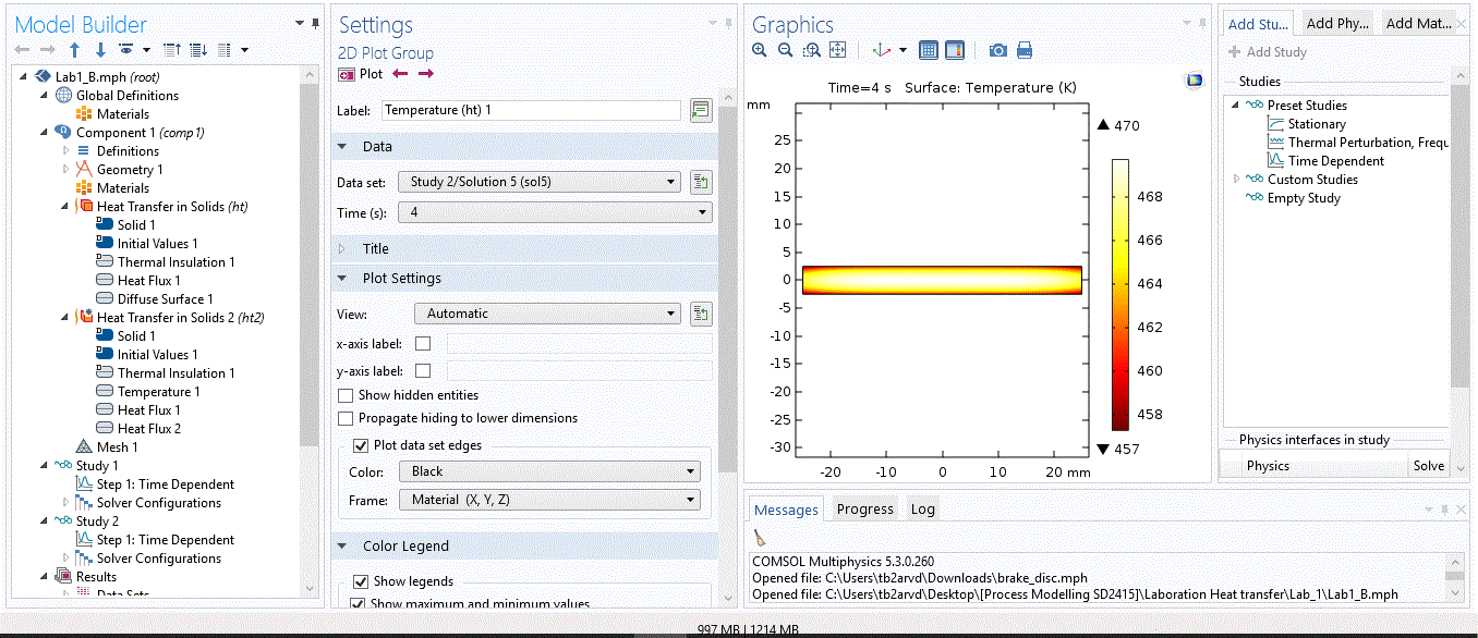

Hi!

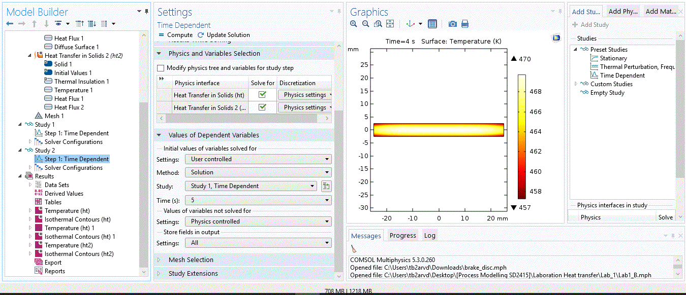

Im working with a process where a piece om material is taken out of a oven at a ceratin temperature, T. Then it experiences convenction and radiation during 5 sec, i call this step1. Then, in step2, where i put it in a mould which gives me different scenarios, for example, bottom surface has a boundary temperature, Tb and only convection on two sides. How do i connect the result from step1 to step2? As of now i have two different physics, "heat transfer in solids 1" and "heat transfer in solids 2", both with different boundaries etc, see attatched picture! I tried to have study 1 and study 2 and in study 2 get values from study 1 but didnt get it to work.
