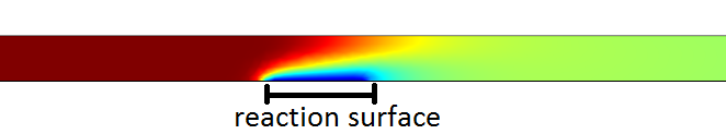

I am trying to estimate some parameters (Kon, Koff) for a surface reaction in a microchannel. The surface reaction is happening along a small part of the boundary in a 2D space. i have the surface reaction module set up to monitor the surface concentration of the formed species (cs_AB).

  2. my reference data actually contains the integral of the surface concentration along the boundary. is there a way to integrate the found surface concentrate cs_AB along my boundary, and then use this value to fit my parameters to the reference data?
