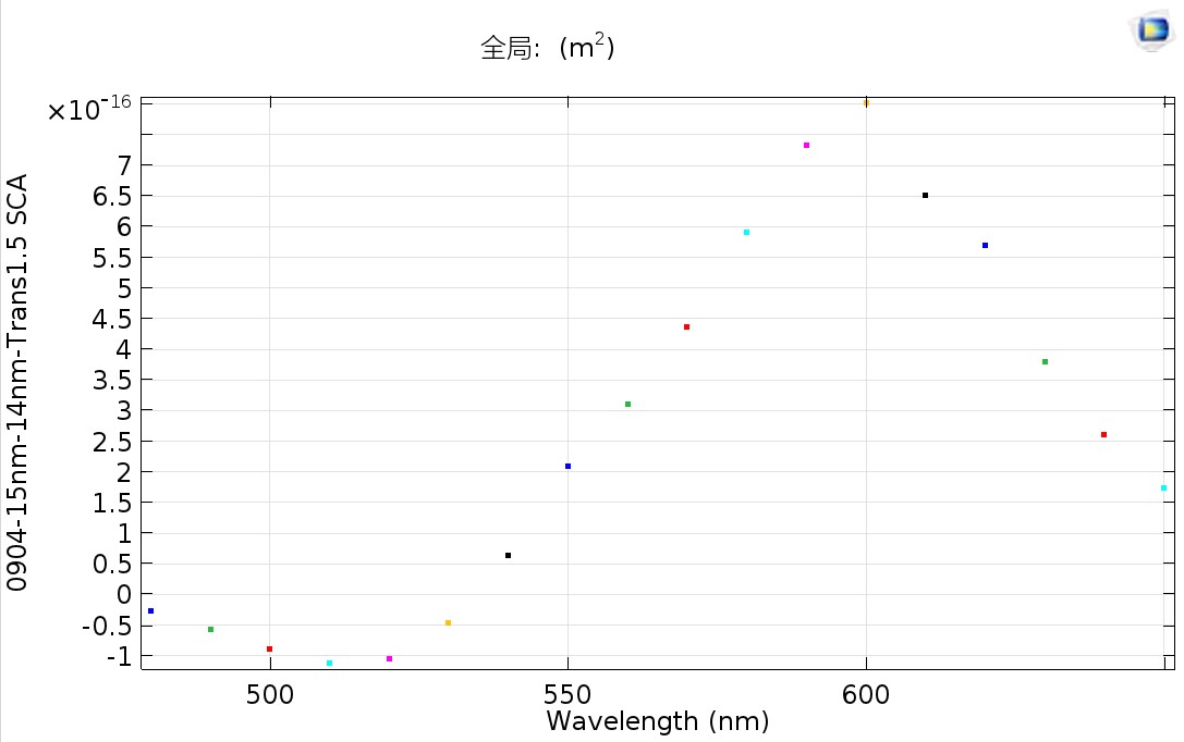

3. While I define ofact=if(nx*x+ny*y+nz*z>=0,1,-1), the scattering value sometimes be negative, does a negative value of scattering corss-section meaningful? (Fig.3)
4. While I define ofact=1; The scattering value could be so low compared with the Absorption value, is it right?
