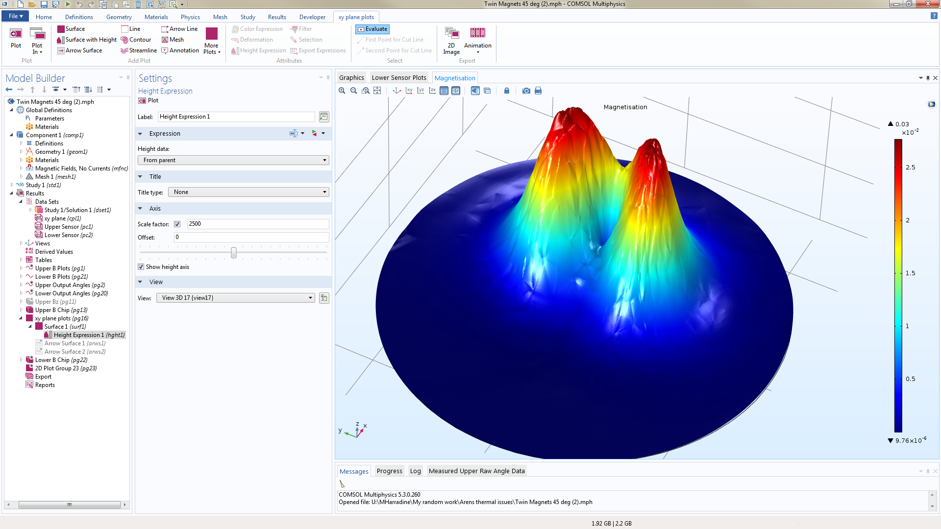

You can add a Height Expression to a standard surface plot in your results, (make sure mesh and cut-plane resolution are sufficient for your needs). See attached example. I am not sure if the Height Expression capability is available in version 4.3...

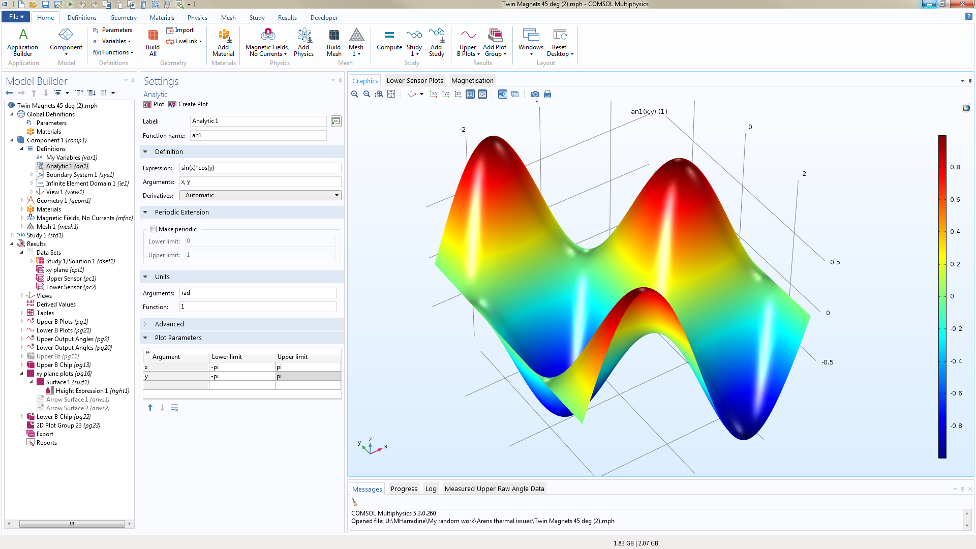

An analytical surface plot can be created if that is what you need (see attached).
Hope this helps,
Mark
