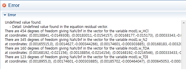

and i consider a density change in my system. so i select concentrated species module !
but when i choose compressible flow(Ma<0.3), i have a error
( incompressible flow is not !! it has not error )
error massage is attached. !!
Hi !! my model is axial symmetry !! so, the unit of mass rate is mol/s !! and i consider a density change in my system. so i select concentrated species module ! but when i choose compressible flow(Ma
Posted: 1 decade ago 16 mar 2011, 14:17 CET
but for incompressible flow you won't be able to conserve rho*u quantity which is not acceptable under any situation.. if possible contact support, they will help you with this error message..
good luck
Mayur
